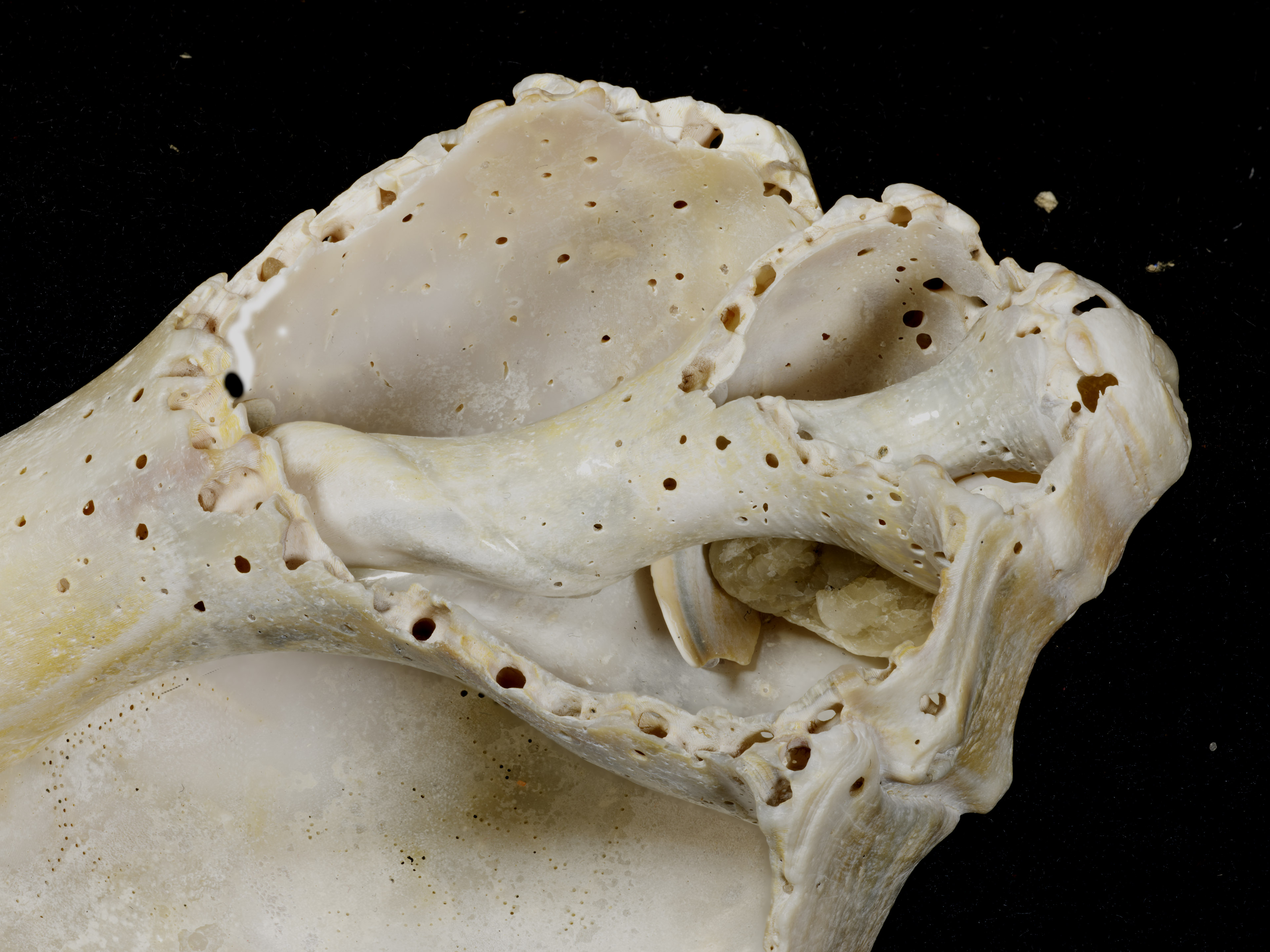

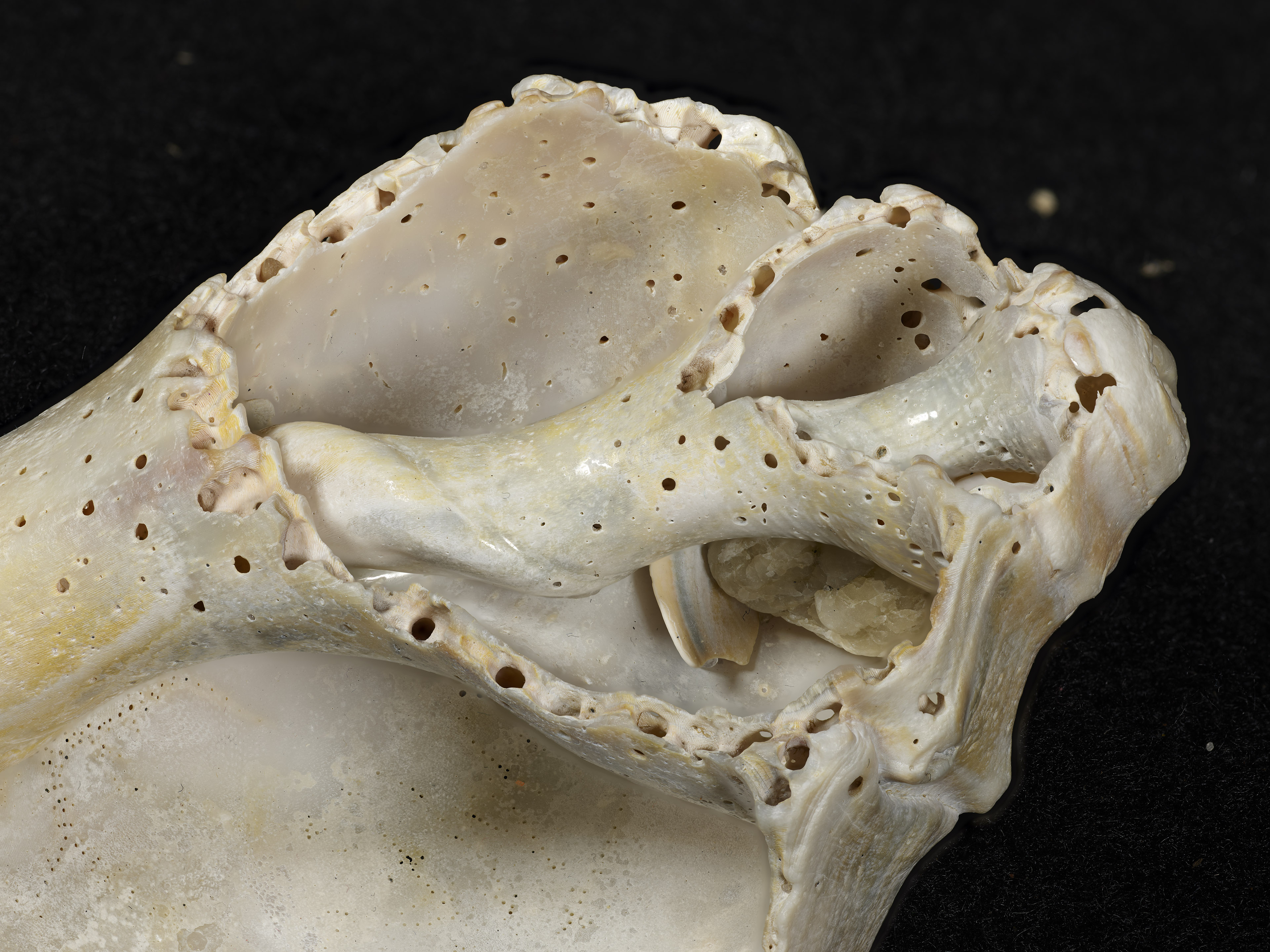

5 Detail of the f/8 image
6 the same detail of the f/32 image

7 Detail at f/8
8 Detail at f/32
9 Detail using some of the f/32 image to cover some of the f/8 image
