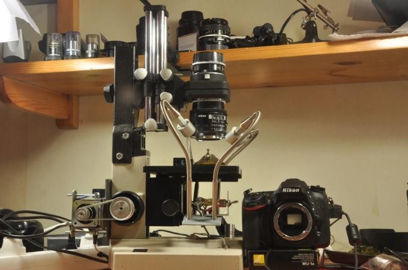

Test D90/D5000 Nikon, D7100 with Helicon Remote.
Hi
I performed the tests with:
- Helicon Remote 3.0.0 w;
- PC running Windows 7;
- Camera connect with USB cable;
- Personal macroscope equipped with a Trinamic motor;
- With Camera Exposure function delays fashion 1s
- Camera not mounted to view mirror.
View Photo
