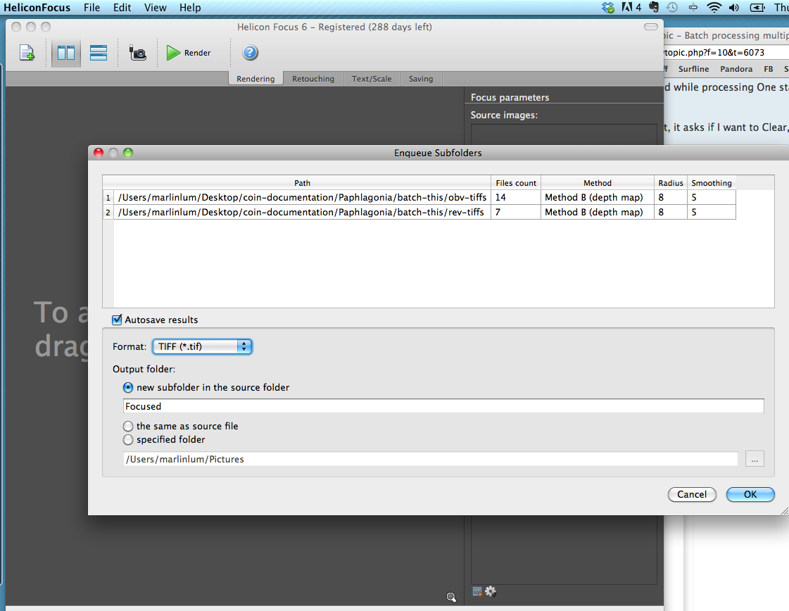

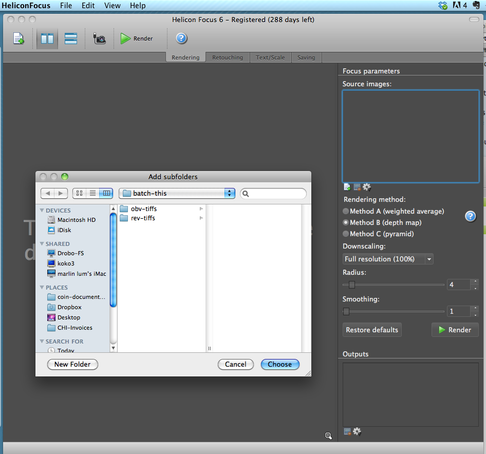

hi Stas,
thanks for the message about the subfolders and batch.
unfortunately, its still not working for me.
As instructed, I went to File, Add Subfolders, browsed to my folders --- try to start the render and it shuts down ....
Attached are two screen shots of my Helicon Focus UI.
Also attached is the Error 'code' that is auto generated by the app after it crashes.
thank you for your continued help.
Marlin.

Re: Batch processing multiple stacks : helicon focus
Thanks for reporting this bug. We checked again and were able to reproduce it. So we add it to our to do list for the next version.
