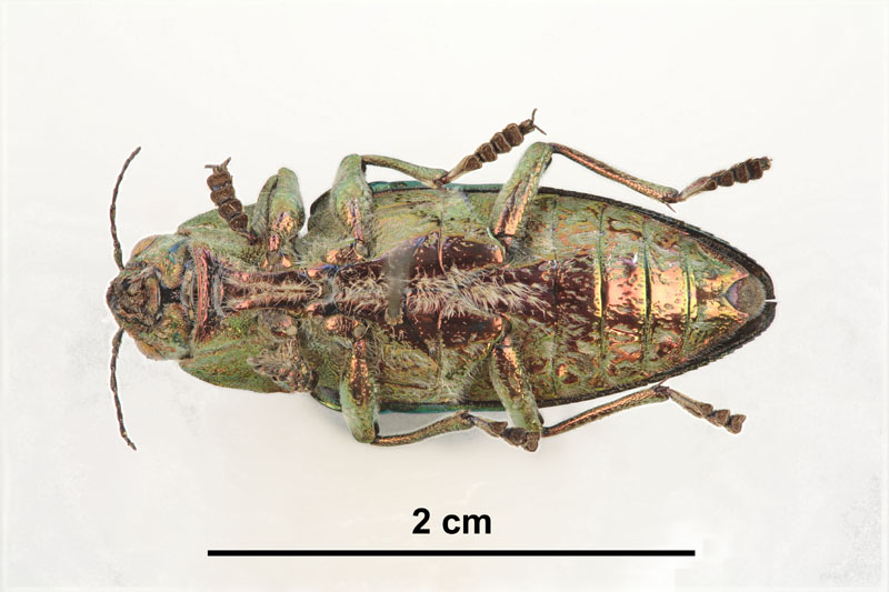

I'm sold.

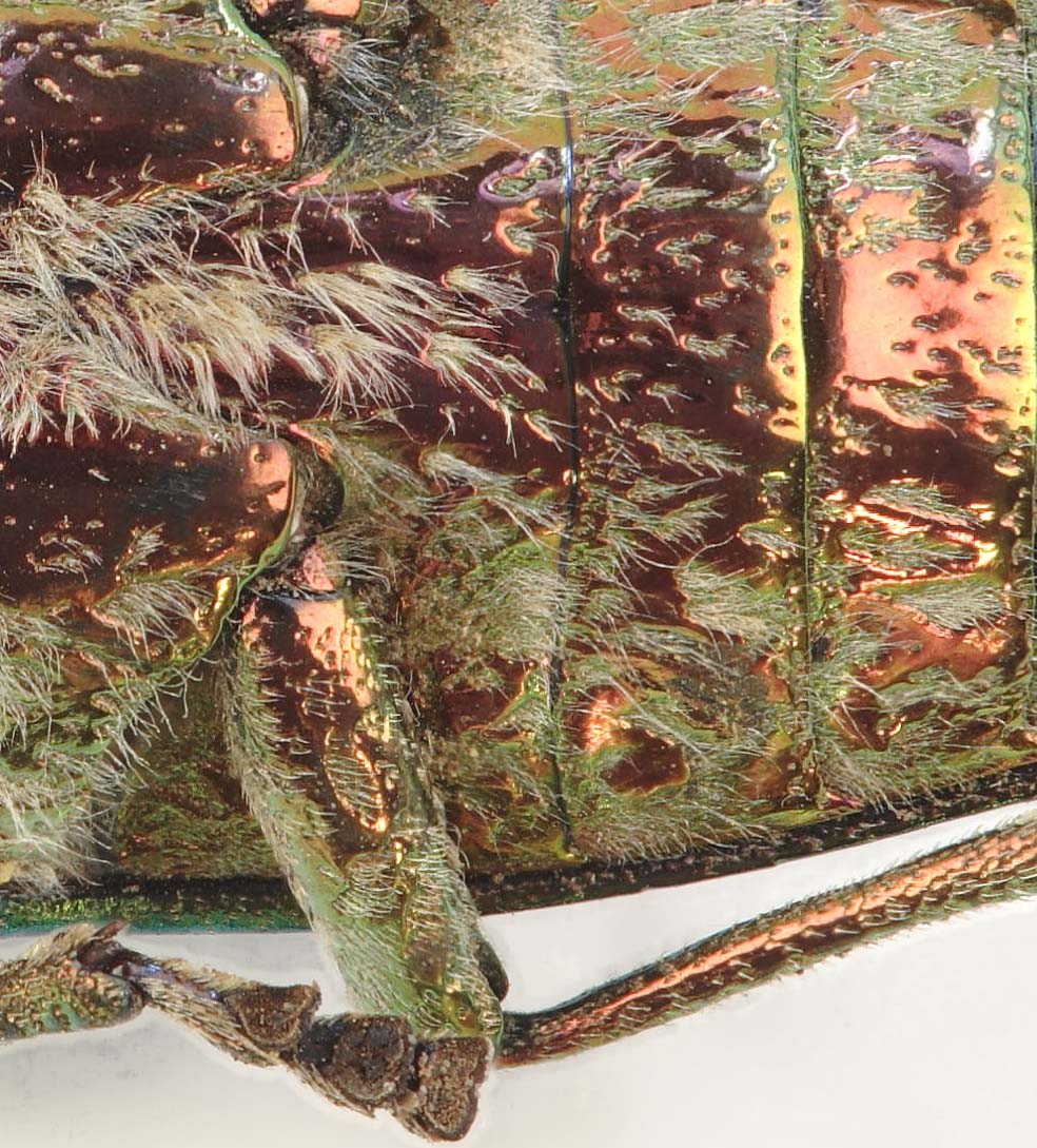

After three goes I was able to produce the attached image. It is the underside of a Jewel beetle, Chalcophora mariana florentina. I have include a 'fit to screen' sized image to give an idea of scale and then cut a full sized segment to show the detail and quality of the stiching. The source images were taken on a Canon 5D digital SLR with a Canon 100mm 2.8 macro lense. 12 shots were taken at f 8.0 with a tungsten light source.
At the moment I am making do with a standard copy stand so the best I can do is movements of roughly 0.5mm. I hope to rectify this soon.
Peter
Chalcophora mariana florentina Scale image

Chalcophora mariana florentina Scale image. Full size segment
(230.19 KiB) Downloaded 3848 times
Unbelievable, how deep human eye can see : ) Great details and overall quality!
