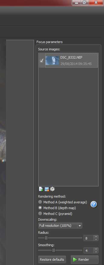

Re: Brigthness changes
Sorry for the delay, I had a hectic work schedule and needed to install new drives and a clean install of W7 before I could have a look.
I don't seem to have the button in question. I don't know if it make any difference but I have only purchased the basic option due to funds and the current time
- Helicon.jpg (18.04 KiB) Viewed 21571 times
- Posts: 3833
Please try this version of Helicon Focus: http://heliconsoft.com/downloads/HeliconFocus6.2.2.exe
