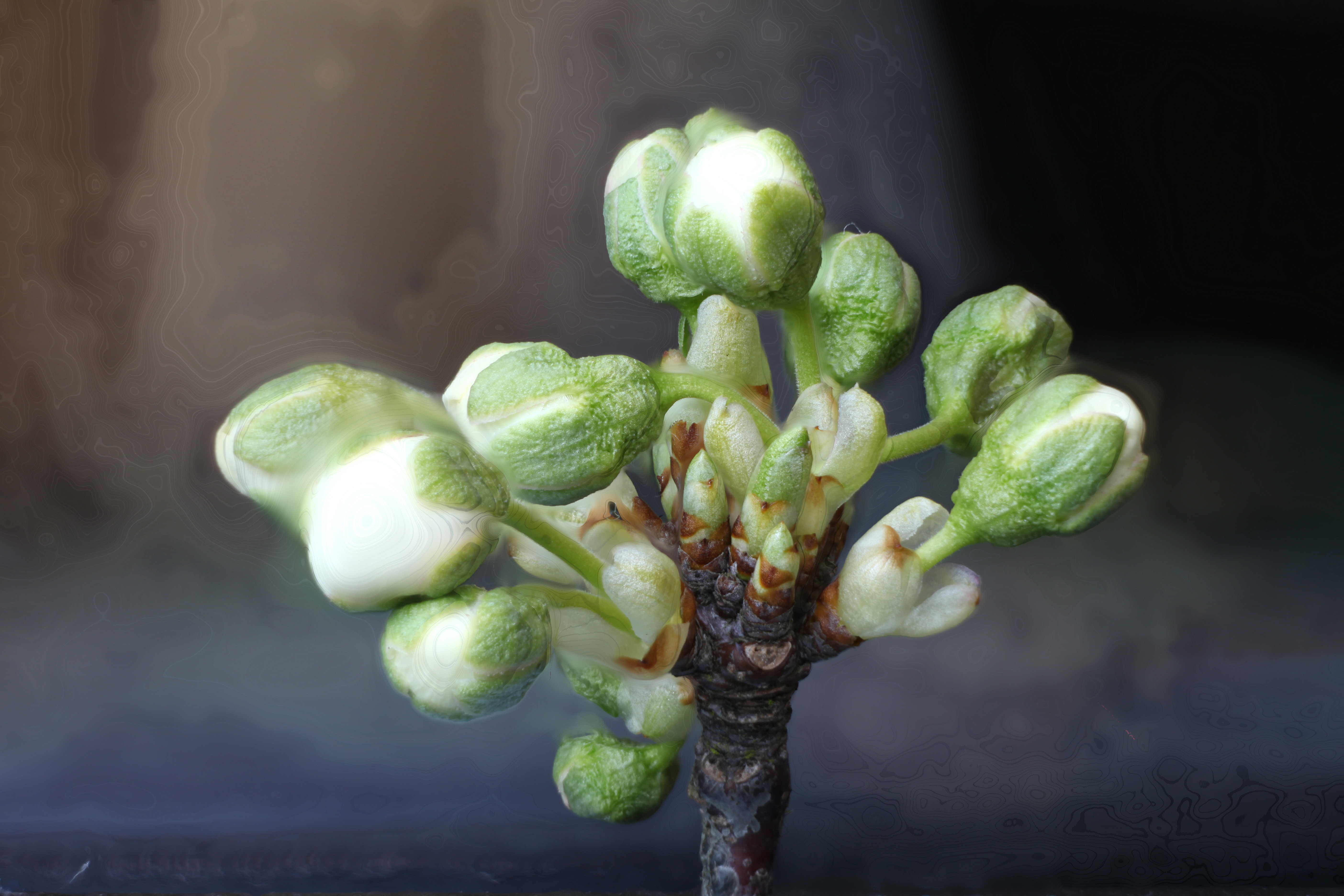

I'm also having trouble with white flowers. Any tips gratefully received.
plum
(8.61 MiB) Not downloaded yet

I have to change my comment a bit, I hadn't downloaded your image.
Now that I do:
- Have you tried all three methods of stacking?
- I found C works best for fine detail but A works best if you want some contrast and colors still.
- Try isolating your background better too!
