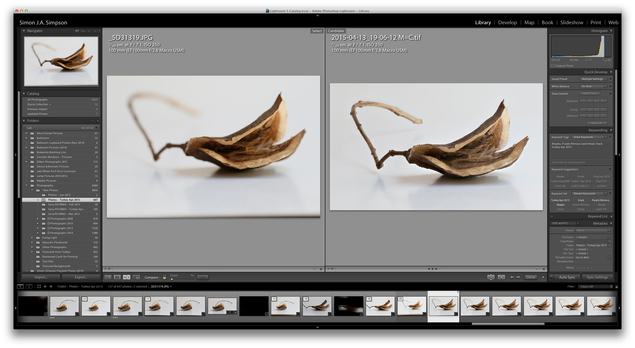

I have noticed that the final composite image is slightly desaturated in comparison to the original images. I have screenshots to demonstrate this. I am using the ProPhoto colour space throughout.

It was my mistake in showing you a screenshot from some incorrectly generated JPGs. But the same applies to RAW files converted to 16 bit TIFFs (see attached screenshot).

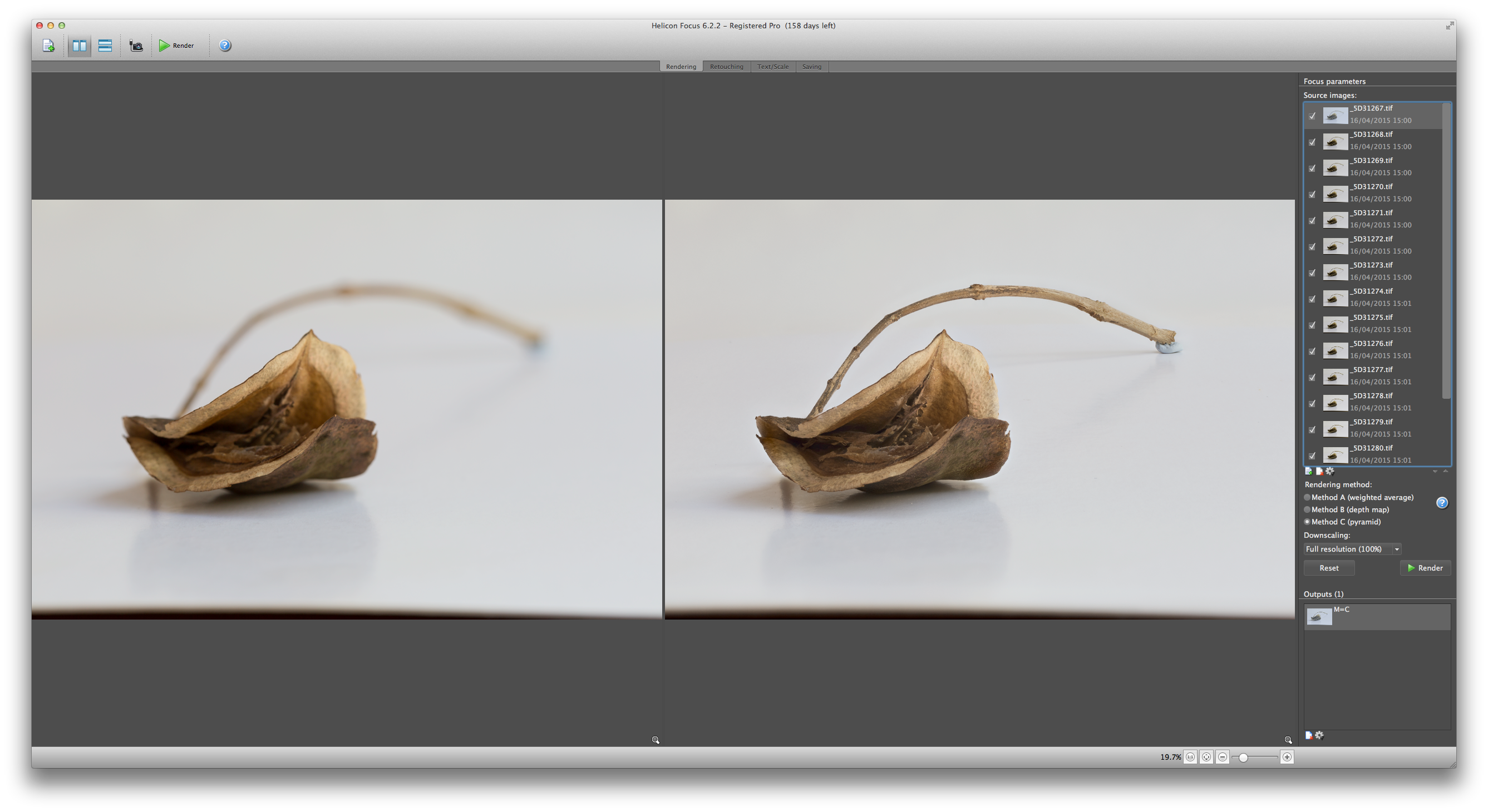

I tried using HeliconFocus 6.3.0 but trying to save the composite image causes the attached error message. And indeed most of the EXIF data has been expunged from the saved composite. Also in earlier tests, on quitting, HeliconFocus 6.3.0 crashed every time (I can send you the crash log if you wish). In later tests it seems to be OK (not crashing), but still the error message and no EXIF data.

I can of course fix the saturation problem in Lightroom, but still it is puzzling; and it would be nice if HeliconFocus retained the original file’s specifications, yes ? BTW, there seems to be no difference in the saturations of the composite regardless of which rendering method I used.

It sometimes does the roundtrip after I've saved the composite and sometimes not. When it doesn't I get an error message when quitting Lightroom. I have now captured this error message and uploaded it (below).

There is an improvement in the matching of the stack and composite images although there remains a very slight difference.

In my test the roundtrip to Lightroom is still not working, the saved version not appearing in LR and the Helicon task not completed. On exiting HF or LR the error message appears (as above).
