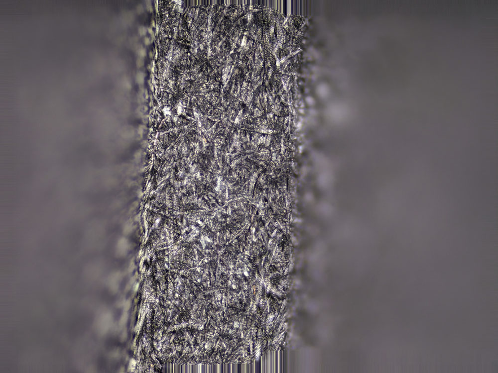

The other day I started a DOF test stack with a microscope objective. Object was a plain piece of black cardboard in a diagonal angle to the optical axis. The (correct) rendered result from HF 6.8.0 looks like this:
However, if I render the very same stack with the very same settings in HF 7.0.0, it looks like this:
(see attachments below)
In both cases I used method C - I also tried methods A and B with basically the same scaling error. Next, I tried to modify the alignment settings which initially had been standard in both HF versions (V 3%, H3%, rotate 0°, scale 5%). I found out that if, in HF 7.0.0, I set the "scale" value to zero, the result turns out fine, just like the 6.8.0 output (keep in mind, I used an infinite microscope objective with an approximately telecentric behavior - I would not recommend using a zero value with a macro lens...). If I set the value to 1%, I already get a misscaled/misaligned result, and the higher a value I set, the stronger the misalignment gets.

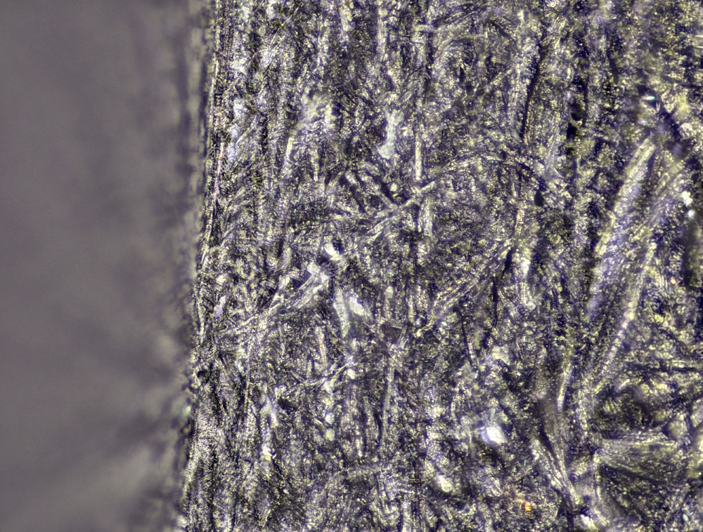

Next thing I tried was using alignment settings 3%,3%,0°,5% again but additionally checking "Manual detection focus area adjustment" - just to see what happens; as yet I don't have a clear idea of what this setting does. This did not give me any additional options (as I had assumed because it's "manual"), but the rendering result looked dramatically difficult:
This result is not correct (pictures that were erroneously scaled up without "Manual detection" are now scaled down a bit, and there is some misalignment visible in details), but obviously aligning is done in a very different way.

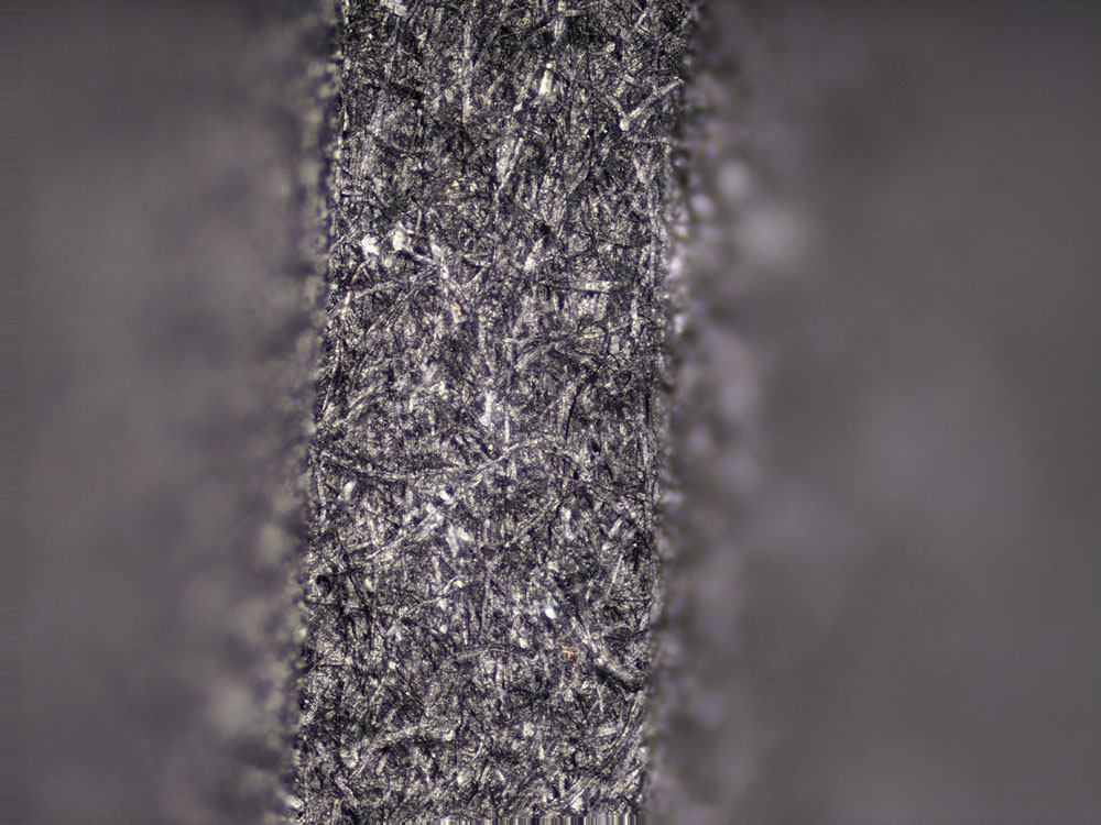

Grrr...you know it's a pain to attach images in this forum? So, here's the picture that should have showed second in the above posting (HF 7.0.0 with default settings):
- 2-10x,5um_HF70_kl.jpg (302.8 KiB) Viewed 10247 times

And here's the third one (HF 7.0.0 with "Manual detection focus area adjustment"):
- 3-10x,5um_HF70,MFD_kl.jpg (169.73 KiB) Viewed 10247 times

Thanks for the stack. You are right, new version does not align images correctly. It looks like this happens because focused area is so small compared to whole image. We recommend to decrease max scale adjustment to 1% in Autoadjustment tab in preferences. Please also note that images are shot not in consecutive order. Focus moves forward, then moves backward. Method B requires images to be shot in the same order

As I also said before: Even if I set the scale adjustment value to 1%, I already get a misscaled/misaligned result, and the higher a value I set, the stronger the misalignment gets. The only way to get a result that looks like that of HF 6.8.0 is to set scale adjustment to 0% - it seems that whatever scaling factor I allow, will be exactly be what the program uses per step (try 20% for a really strange result).
To avoid misunderstanding, I myself do not need a solution for this special stack - using 0% scale adjustment or HF 6.8.0 does the job. The question is just if problems like this might occur in more relevant situations (and if they might be avoided without sacrificing HF 7.0.0's speed gain, regarding that HF 6.8.0 is slower, but more robust in this respect). The small size of the focused areas is something that is quite usual with microscopic stacks due to low DOF - the constant and continuous steep angle of the object surface (resulting in the "straight strips" of focus area), on the other hand, is not. I never experienced any such problems with HF 7.0.0 in "regular" object situations, be it macro or micro.
