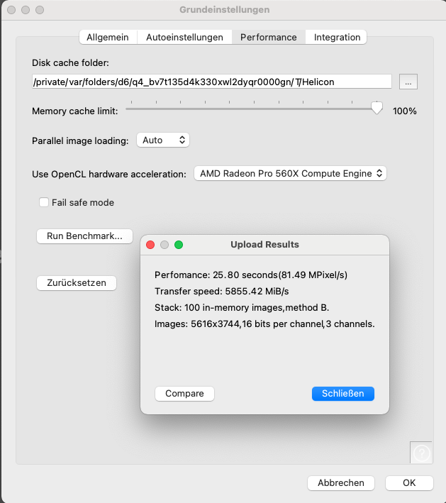

  • AMD Radon Pro 560X Compute Engine:
Performance: 25.80 seconds (81,49 MPixel/s), Transfer Speed 5855.42 MiB/s

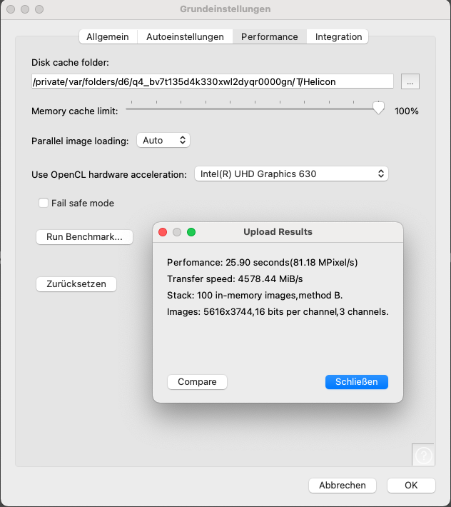

  • Intel (R) UHD Graphics 630
Performance: 25.90 seconds (81.18 MPixels/s), Transfer Speed 4578,44 MiB/s

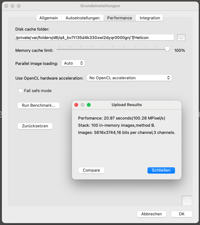

  • No OpenCL acceleration:
Performance 20.97 seconds (100.28 MPixel/s)

AMD RadeOn Pro 560X
AMD RadeOn Pro 560X
Bildschirmfoto 2021-07-12 um 20.05.05.png (108.96 KiB) Viewed 6232 times
Intel(R) UHD Graphics 630
Bildschirmfoto 2021-07-12 um 20.03.30.png (109.54 KiB) Viewed 6232 times
Bildschirmfoto 2021-07-12 um 20.01.49.png (111.91 KiB) Viewed 6232 times

We have a number of benchmark results reported by users for AMD Pro 560X, ranging from 75 to 250. The majority of the results are in the 130-140 range, which is more that you've got, but still quite low compared to the CPU score. It is what it is, this is not a powerful GPU, and the transfer speed of 5800 MiB/s is lower than what it should be with PCI-Express x16 3.0 (9000-11000 MiB/s), this also impacts the total score.
81 is a reasonable score for UHD 630. The majority of the results in our database are around 90, but this is negligible difference that could be down to thermal performance of your laptop (the higher the GPU temperature is - the lower the GPU clock).

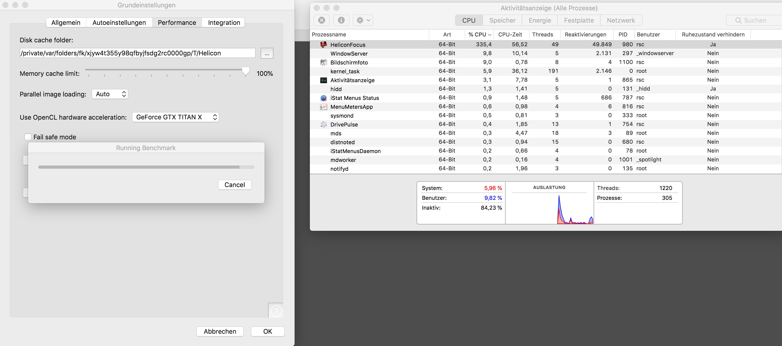

the Titan X isn't as fast as expected....
According to Helicon Focus, it gives rates of 145.54 MPixel/s :(

What's interesting in that case is the fact, that the GPU makes no noise at all. Normaly, when drawing high GPU-power, the fans get really very noisy/loud.
And additionally: even though I run a GPU Test, the CPU load is very high if you keep in mind that the system is powered by a dual XENON hex-core.
CPULoad while running GPU-Test
(524.84 KiB) Not downloaded yet

The transfer speed in your benchmark is about 3 times lower than it should be, it accounts for a lot of GPU under-utilization. This indicates a problem with PCI-Express link speed, a hardware issue.
The CPU spike at the beginning of the benchmark is perfectly normal, it's the preparation of the test images. This phase does not affect the benchmark score.
