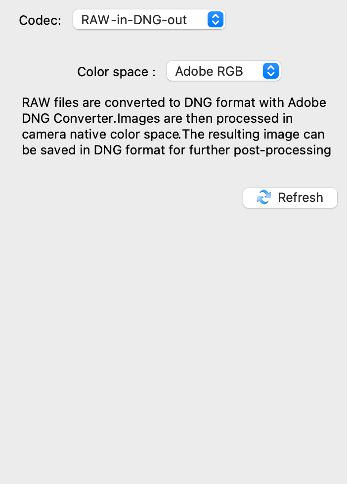

I've made sure to download/install the latest versions of Camera RAW and DNG Converter, and have my settings in Helicon Focus set to RAW-in-DNG-out.

As long as "RAW-in-DNG-out" raw decoder is selected for CR2 as well, there is absolutely no difference in how they are treated. The only possible difference is that CR2 may be faster to decode so the button doesn't have enough time to show up in the task bar.
Also, make sure to compare the first render after loading the images into Helicon Focus. The second and subsequent renders will not invoke the DNG converter thanks to caching. Again, regardless of the specific raw format.

That is a possibility for sure. If it is true, it is quite astonishing how much faster CR2 decodes compared to CR3. The caching feature is great, as the converter doesn't need to run as you stated. Interestingly enough, if I open DNG Converter and convert the files to .DNG first, the performance is identical to CR2 files. In the end, the output file is saved as a .DNG, so I guess it really doesn't matter in the end since I do my editing post-stack.
