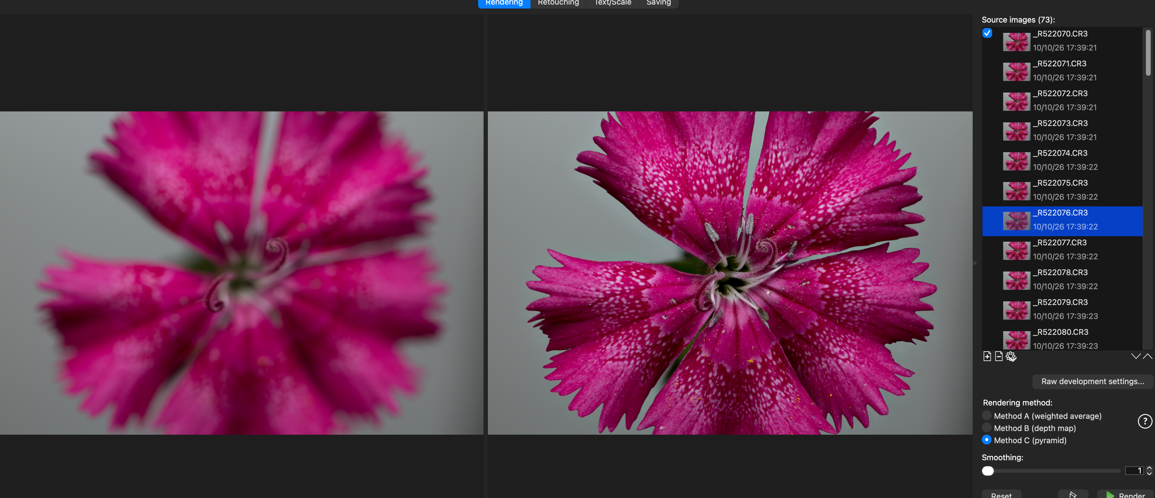

Aslo I have attached a photo, I noticed there are no check boxes anymore next to the source files where you can pick files you might not want to use in different stacks. there is only 1 box on the first image and that is it. I did notice, though after I do a few stacks and I switched back-and-forth from the outputs that some of the boxes start to show up, but they show up on top of each other, not next to the source image and if that ever happens again, I can try to take a screenshot, but it's it's hit or miss. I guess I should say when that happens.

- no check boxes next to source images

Check boxes - yes, we know, also investigating, as well as the first two problems (the dark result, and the outputs not being raw).
