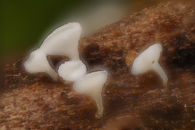

Hi all,
I ' am unable to reduce Halos as per attached sample.
Image was made from 46 single shoots.
Scale arround 15:1, Nikon Flash SB R 200. JPEG.
I' ve tried smoothing: 4 and Radius: 3
Used version 4.21 Pro
Hope you can help.
Thks.
Murphy

Try making smoothing high and radius low or vise versa.

Post by Ken Eis »
I had the same problems with the R200. I presume you have these strobes mounted on the camera lens. The halos will go away if you take the strobes of the lens which moves during the stacking process. Its the result of "stobe paralax" my term.....
