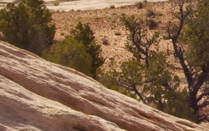

I've been trying to eliminate the blurriness that often appears at the edges between a somewhat smooth area and an area that has more detail. For instance, at the edge of a near rock with trees in the distance. I've attached a 100% crop of an image. As you can see, the edge of the rock is sharp and most of the distant trees are also sharp. But the tree area next to the rock, at the same focal plane, is blurry. I have tried many different settings in Helicon, but nothing seems to help. This happens in most images. Any suggestions?
I"m shooting with a Canon 5D MKll.

Merrill,
Try to set lower values of Edge feathering in the Helicon Focus Preferences. Lower Smoothing value should also help.

Re: Blurry edges
Me too....
I also am seeing quite a bit of blurring along edges between high detail and lack of detail. I have tried reducing the smoothness setting and lowering edge feathering but to no avail. Any further suggestions??

Re: Blurry edges
I would also suggest to set lower value to Depth map feathering in the Preferences.

Re: Blurry edges
in my opinion there is no way to remove completely such blurry lines when something in the front covers something in the far background in one axis...just optics roles!!!!! to bad!

Re: Blurry edges
You are right, blurred object on the foreground may mask the details behind it, so the program simply does not have enought information.

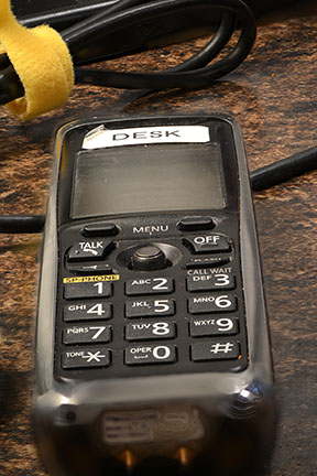

Re: Blurry edges
I'm having a slightly different problem related to blur and moire patterns. I've uploaded reduced test file that I did of a cordless phone on a desk, and enlargement details of areas mentioned below. The desktop has a pattern, and all objects were shot completely still. Notice several things. The desktop has what the program rendered as granules of dust or debris, but in reality that is only some strange rendering of the patterned desktop. Next, notice the significant blurring along the edges of the phone. Last, notice the patterning at the bottom (nearest edge) of the phone. I set the nearest focus to the bottom of the phone near the small vertical contact strips, but the entire bottom had the final result in a very strange pattern and out of focus. This was shot as jpgs with a Nikon D800 & Nikkor 105mm Macro, using Helicon Remote (155 images were shot and composited).
So, am I missing somehting or are there some limitations on patterned backgrounds, etc.? Any help would be appreciated.
- desktop_detail.jpg (46.11 KiB) Viewed 20045 times
- See my comments in 12-29-2012 post
- test_full.jpg (62.04 KiB) Viewed 20045 times
