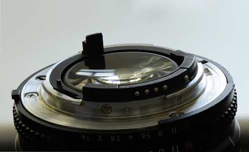

- sexy back of Nikon 50mm 1:1,4
- Nikon 50 1-1,4.jpg (102.9 KiB) Viewed 15027 times
