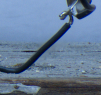

Also i kind of see some "blurs" on the boundaries of certain objects,(like the one i attached), maybe i can fix this with some settings ?
What about the halo's ? are they cause of the parallax error ?
Posts: 3833
Re: Nikon D600
This can be an optical problem because unfocused foreground object masks background. But this also can be an algorithm artifact. You can try reducing Radius when using method B or to use method C.
