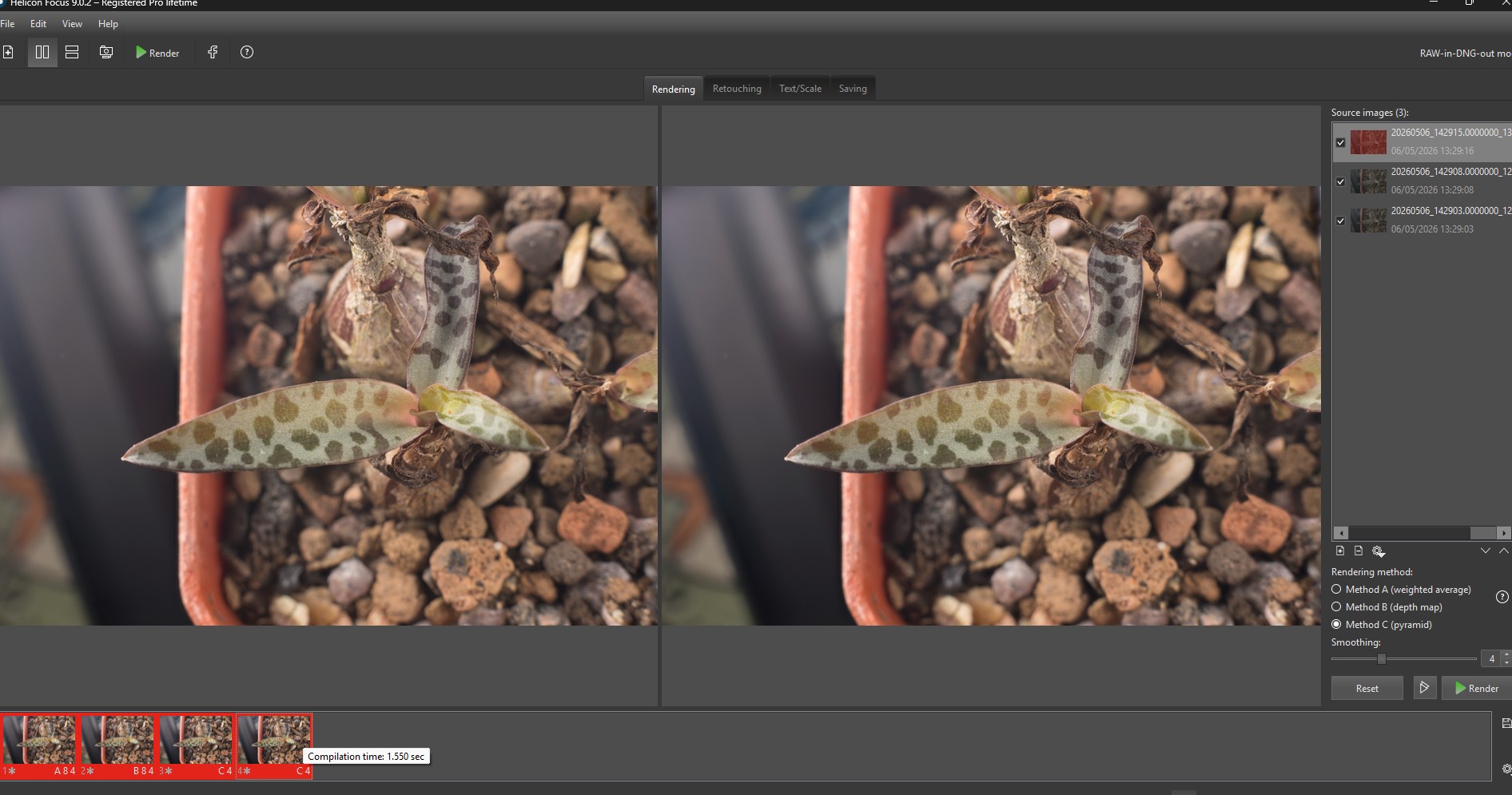

I think there's a problem with saving a batch of saved images in Save All images
Make an A B and C stack
Select all three images
Right click and choose to make a stacked image
Select all four images and choose to Save All images
The three first stacked images are saved. The fourth image (the stack made from the stacks) is not saved but the information box says four images saved
Posts: 1850
Re: Helicon Focus 9.0.2
Interesting, thank you, we're looking into it. By the way, "Save All" means literally all and is not affected by selection.
P. S. I can't reproduce the issue, I get all the resulting files including the one from "Stack outputs".
Post by el48tel »
I'll see if I can reproduce it again tomorrow with another set and with the original set.

Posts: 1850
What are your saving options? I suspect the same folder as source files, which for the stacked outputs would be the temporary folder.
Posts: 105
Joined: 22.06.2016 17:05
Post by el48tel »
For the purpose of beta testing and for the purpose of this test ..... the source folder contains only the RAF files. They were CTRL-A and dragged into 9.0.2 which was loaded directly (not LightRoom).
The save option for stacked files was a nominated (from the dialogue box) subfolder within the test folder.
If I save the three stacked ABC files after stacking they all save to the nominated folder.
BUT if I include the re-stacked file that does not save but the original ABC files do save
Posts: 1850
Yes, that's what I'm saying. It is saved, as instructed, to the subfolder of the folder where the source images are. The output images are in the temporary folder, therefore the result is saved to the temporary folder with these settings. Maybe we'll think of something, but there is no simple solution (other than not use these saving options when using Save All and stacked output; use a specific folder instead).
Posts: 105
Post by el48tel »
Ok I understand but it seems strange that the stacked ABC save to the nominated source folder but the newly stacked image goes to the temporary folder
