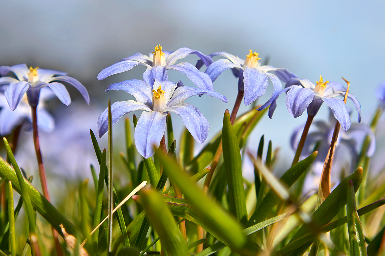

These flowers are shot handheld with Canon 90D, using canons built in focus bracketing.
6 shots rendered with helicon focus.
