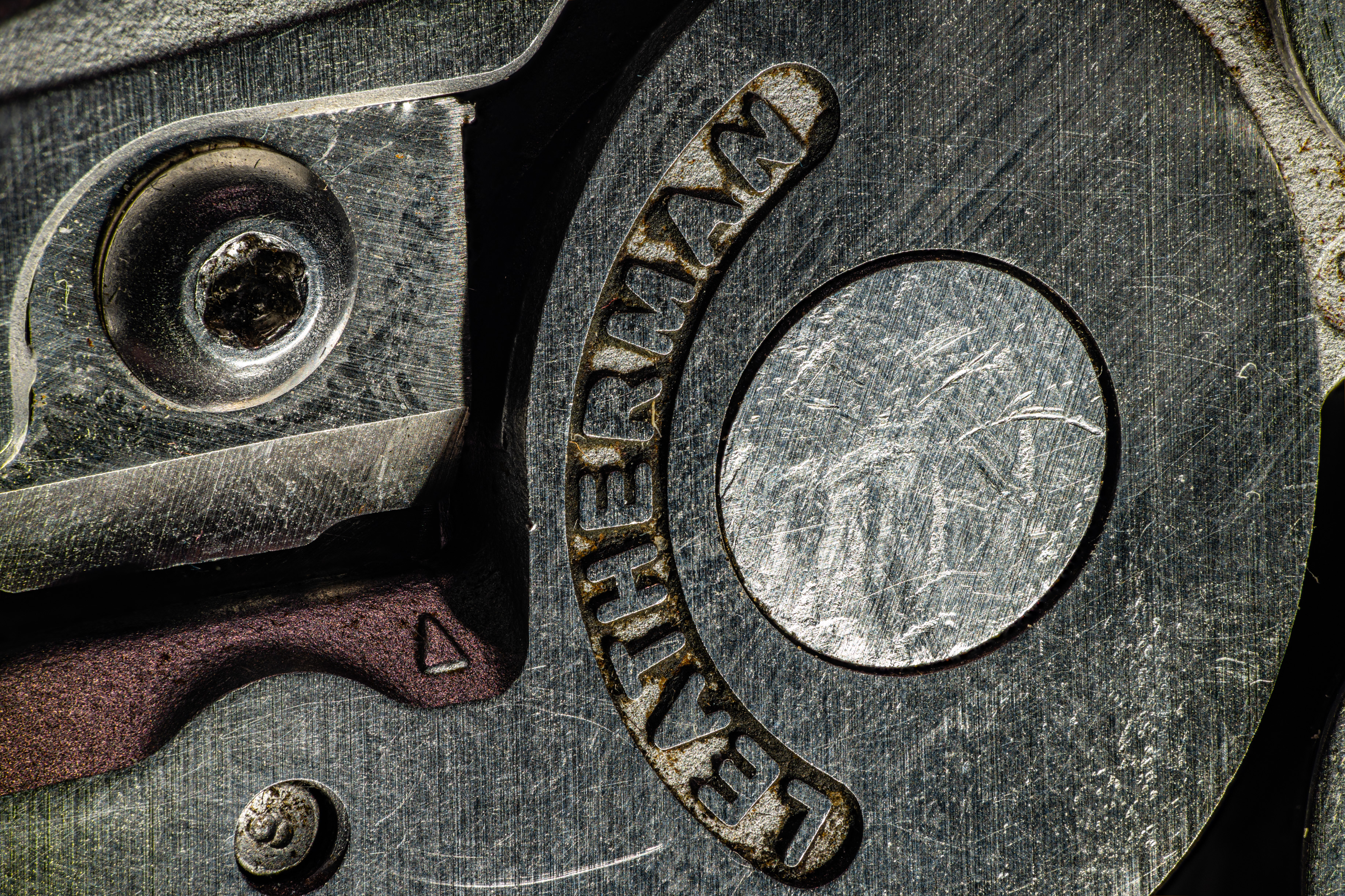

After I started this thread, I switched my camera to 5ghz wifi mode (from 2.4ghz, I used direct wifi for testing, not via my router) and everything sped up 4x and this was enough to make it usable.
I attach a 75 photo image stack made automatically with the Helicon remote, Focus, with a Sony A7IV as proof.
Basically the photo triggering and focusing works, everything else does not. I have to change all settings on the camera itself, I do have a live view from the camera and focus peaking works.
The main issue at the moment is not being able to just save the raw photos in camera, and not download them each time a photo is made. Even with 5ghz direct wifi connection it takes like 5 seconds, multiply that by 75 + all the exposure time and focus changing, and making a single photo took 10 minutes (1/60s shutter speed).
