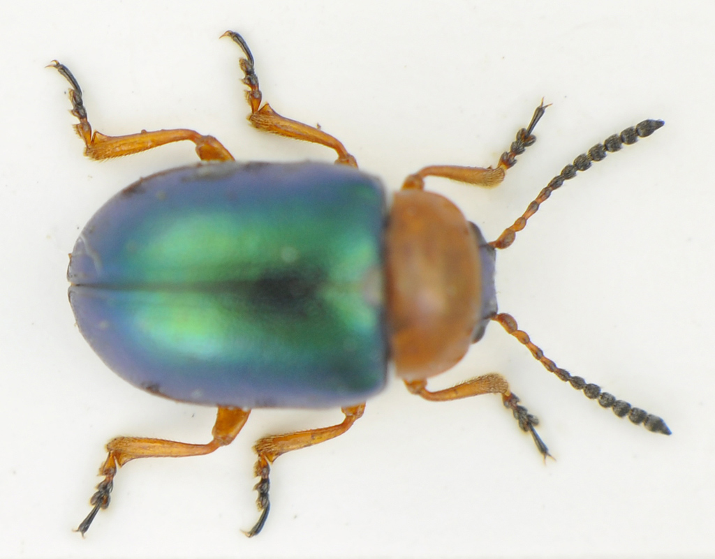

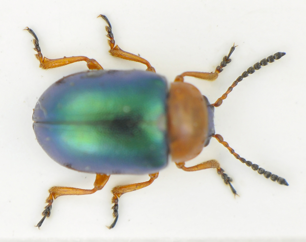

Please see below the setup we use to test focusing steps. The second image is 100% crop. With such setup it easy to follow how the focusing plane is moving. If the focusing step is ignored, you will see this at once.
