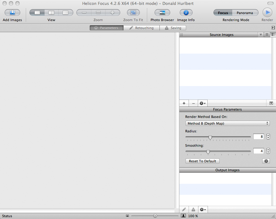

I've purchased Helicon Focus 4.2.6 X64 version for MAC.
Helicon Focus X64
Helicon Focus X64
Helicon Focus X64.jpg (242.22 KiB) Viewed 8406 times
I tried downloading the update for Helicon Focus 4.2.7 but keep getting errors when I launch the .DMG file. It says file not recognized, failed to mount.

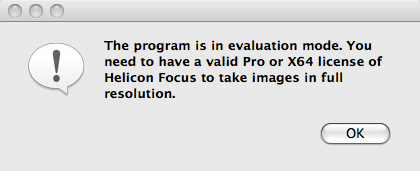

The Helicon Remote (ver 2.0.5) beta says Limited Functionally at the top.
I get a message when I start Helicon Remote that says " The program is in evaluation mode. You need to have a valid Pro or X64 license of Helicon Focus to take images in full resolution."
Message from Helicon Remote
Helicon Remote Message.jpg (63.88 KiB) Viewed 8406 times
It sees my Canon 5D Mark II and turns on live view. I turn off live view and take a shot. I have strobes connect to my camera via sync cord. I can take a photo, the strobes will fire. But no image appears on the screen. After that, I can't take anymore photos.
Where is the fully function Helicon Remote (beta) since I do have a valid X64 license?
What else am I doing wrong. I've downloaded the steps on how to use Helicon Remote, but I can't get past the start up.

Re: Helicon remote not working
Posted: 26.01.2011 12:24
by Stas Yatsenko
James,
Please try this version of Helicon Remote Mac: http://www.heliconsoft.com/downloads/HeliconRemote.dmg
