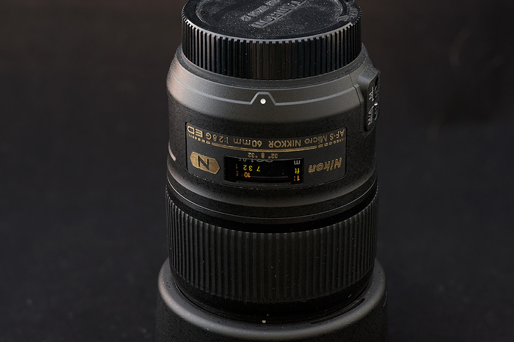

Got this one with 17 shots at f11.
I was actually able to get it to cooperate with Remote. But I will probably be sending it in for repair.
- Focus-Result-(B,-8,-4).jpg (146.87 KiB) Viewed 16096 times
