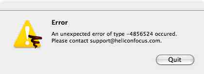

I am using 3.5 unregistered. I load the images and run. When complete, after a few seconds, the program quits. I cannot save the result, even if I try to intercept with control-S. Using 16-bit tiffs, but get the same result with the demo images.

Downloaded and installed. Now get error of type -4856524. Nothing in console with demo. Invalid tags with my 16-bit tiffs.
Also have dual processor, but allow multiprocessor support grayed-out.

Do you have Mac OS X 10.4.8?
Guest
Post by Guest »
Yes I do
Seems to be a problem with 10.4.8. We are working on it now.
