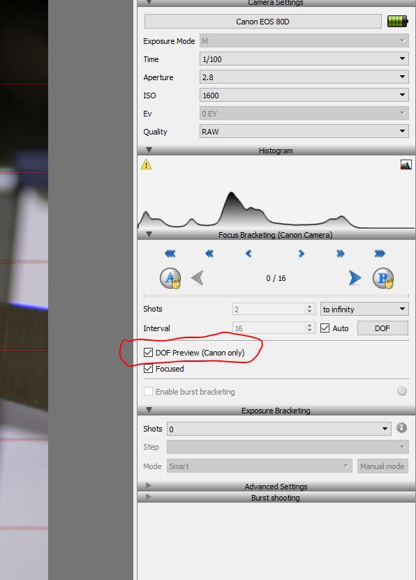

Thanks for the info, we'll be further testing focus stacking with DOF Preview enabled - hopefully, the problems during focus stacking process occur because we're doing something wrong with DOF Preview - perhaps, we're turning it off when we shouldn't. If so, we'll fix it.
We've tested 80D with Canon EF 24-70mm f/2.8L USM and with Canon EF-S 17-85mm f/4-5.6 IS USM lenses, with and without DOF Preview, and we did not observe any of the weirdness that you've described. We did observe minor focus drift, and also some occasional hiccups/lost steps that should occur and that we will be looking into (although so far we can't find anything wrong in our programming in that regard).
So, it's not that the 80D body just handles focus commands differently. So far it seems that the problem only occurs with 80D and a Sigma lens, not with Canon lenses. Do you have any Canon lens?

Well, the 80D does handle the focus workflow internaly different as the models before. I got this information from a developer of a medical solution who uses the 80D in combination with a newer endoscope, that the company develop he work for. He could'nt tell me the details because an non-discloser agreement he must sign.Stas Yatsenko wrote: 18.04.2018 21:04 So, it's not that the 80D body just handles focus commands differently. So far it seems that the problem only occurs with 80D and a Sigma lens, not with Canon lenses. Do you have any Canon lens?
He told me that the newer EOS needs to be switched into a manual focus mode previously you send a stepper command for the focus move. This must be different as before. Is it?
The body does'nt have such menu entry or function key who do this. I had seen that the canon eos utility has a button doing this.
In addition, their must be some newer commands availale who are not describted in the EDSDK and some monitor-Messages (what ever this means) must be handled too. I am not sure if this is related to the focus issue. I am not know'n him personaly and i woul'nd ask him further about the details but the gives a some interessted points where i need to do some further investigations.

Re: Focus stacking with Canon 80D and iPhone
Well, i guess i had found the source of the issue. The phonecall was quite helpful to walk in the right direction. he had absolutly right that the internal workflow must be changed.
I wrote me a very tiny application who just connect the body, init the handlers, readout the camera's vendor-id, model, serial-Nr and some other info.
A simple loop who just send the sequence: "set liveview on -> step forward 3 steps -> set manual focus -> set Capture_full (not halfway) -> delay 200ms". If the loop counter reached 24 ,end the loop " move back 24 steps -> release the mirror-> close usb.
The back-move of the focus from the destination back to the start point is build by a second loop.
Some variation will be checkt too if there is a different behavior or not.
I had unexpectly found out, that canons EDSDK requires to read the camera's model and id before any further task will be done. I guess that they dispatch the used command sets for the different methodes they had implemented in the bodies. An USB-Dump will get clear what they send to the different bodies.
I expect that the canon 5DMk4 will work too. If so, i will ask my frend about the eos 600D to prove, if this works also on that model.
That's the quick description of the process.
This example works with every lense, Canon and Sigma, older and newer, i had checked on the EOS 80D. at the weekend if a spare time is left, if will do this in combination with the EOS 5D Mark4.
unexpectly, the oldes lene Sigma 70mm f/2.8 DG Macro uses a micromotor - but don't lost steps even i move ove 30 steps forward and backward 4 times. This surprised me, the 200ms interstep delay is a short time for that.
I had done a picture set and stacked them in affinity photo and thsi seems to be ok so far. It's not an art, just to check the methode.
Additionally i will attempt to find out how the method works to read-out the shutter- and mirrorcount. An USB dump is available of a working tool who do this successfuly. This API seems to set a debug mode option on (MonOpen, MonReadAndGetData, MonClose) to get this info.
