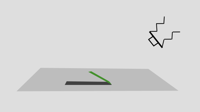

I tend to make several renders per image in order to find the best one. Some of them are good in areas where others are weak and visa-versa. I would like to be able to use one of these other rendered images for cloning/retouching into the render that I have chosen as the best. So, instead of using F9 to choose my source image, I would, for example, option-click a different render, which would then become the cloning source.
It seems counter-logical to me, to be cloning from un-stacked source images, where depth of field may be extremely narrow and I may need to work from several source images to fix a single area, when there is a perfectly good render sitting there unused and which would make the job an absolute breeze!
Here's an example :
The object (in green) is obscuring a large area (dark gray) in terms of depth of field, which could represent perhaps 7 or 8 separate source images in my work. The C method would give me a sharp edge and clean render in this area, but it would be very unlikely for me to want to use a C render because the 'look' it creates doesn't suit my work. So, I'd like to be able to use the B render as my choice, but to brush in the C render in areas where it is suitable.
