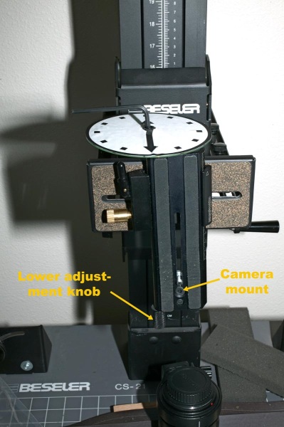

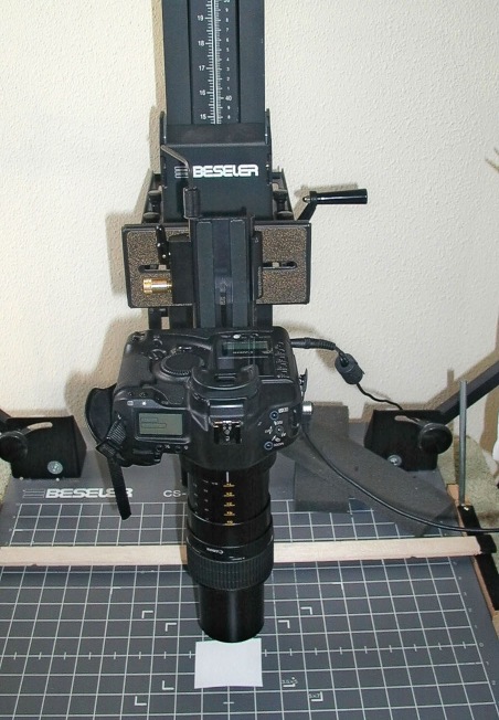

A knob without a large dial scale cannot easily be turned with such accuracy. This is how I do it.
I printed character No. 146 (clock dial) from Windings2 at font size 550 in Word, cut it out and pasted it on an old CD. I fixed this CD to the control knob of the macro rail. In the case of the Manfrotto the center hole fits just over the knurled knob.
The increments that can be visually achhieved with this clock dial are: 242° = 8 hours, 92° = 3 hours or 1/4 turn, 54° = 2 hours, 38° = ?? and 29° = 1 hour. The only problem is with 4x magnification requiring 38°. You can shoot either at 45° intervals (8th) or 12th interval, depending on whether you wish more or less overlap. Alternatively you can create a second scale with 1/10th intervals and glue it on the flip side of the CD.
See picture of Manfrotto setup.
