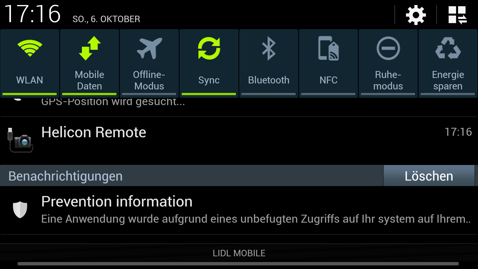

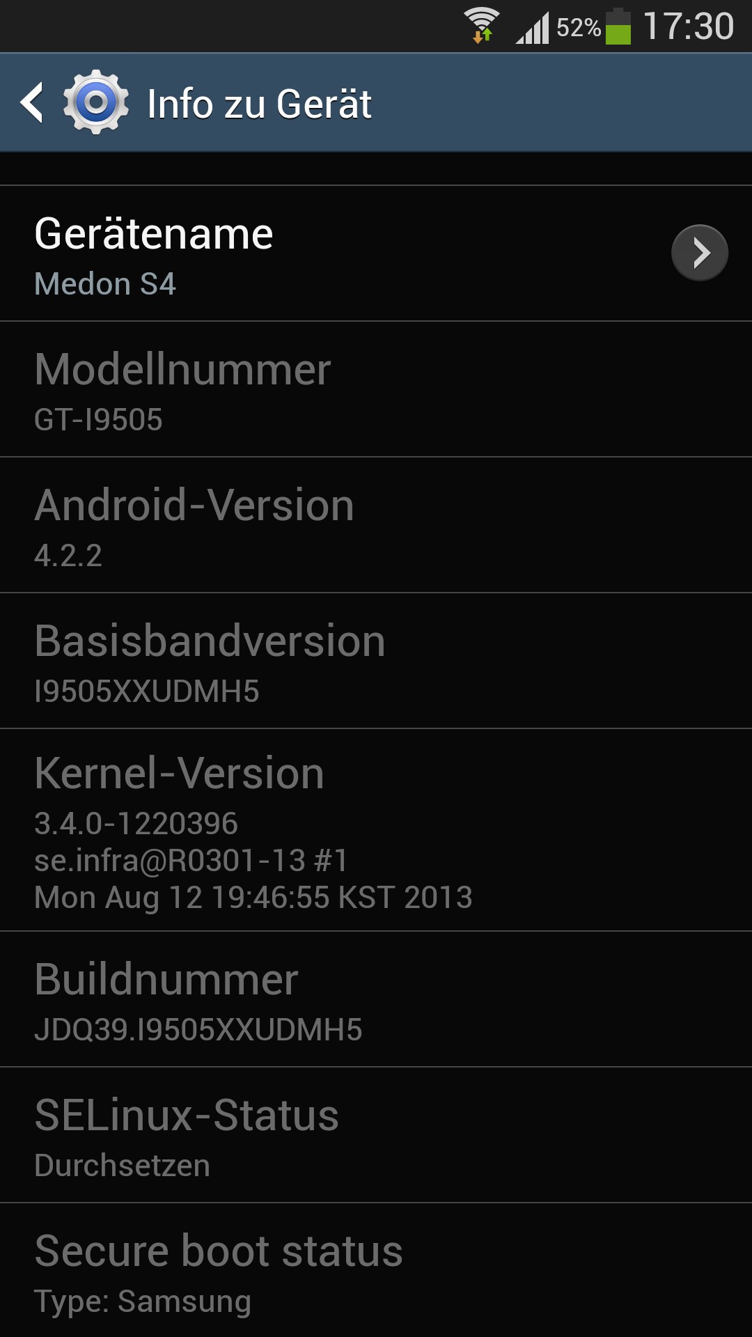

my Samsung Galaxy S4 w/ Android 4.2.2 won't let Helicon Remote run.
The App starts when I connect my Canon EOS 550D via Samsung USB OTG cable, but then there's a "Prevention Information" message popping up - some system message.
Seems there is some strange security mechanism built into Samsungs ROM and it doesn't like Helicon Remote...
... yet?

Re: Samsung Galaxy S4 - "Prevention information"
No idea what's that. Are you sure it's a built-in feature and not a 3rd-party app you've installed?
Yarosia
Hi... that's the samsung knox that introduced this problem... https://www.samsungknox.com/overview/app-developers
Here is the link for the developer to contact samsung and try to fix this. Knox is going to be included on some samsun devices so the problem will not stop only around galaxy s4
Thank you, we're looking into it.
