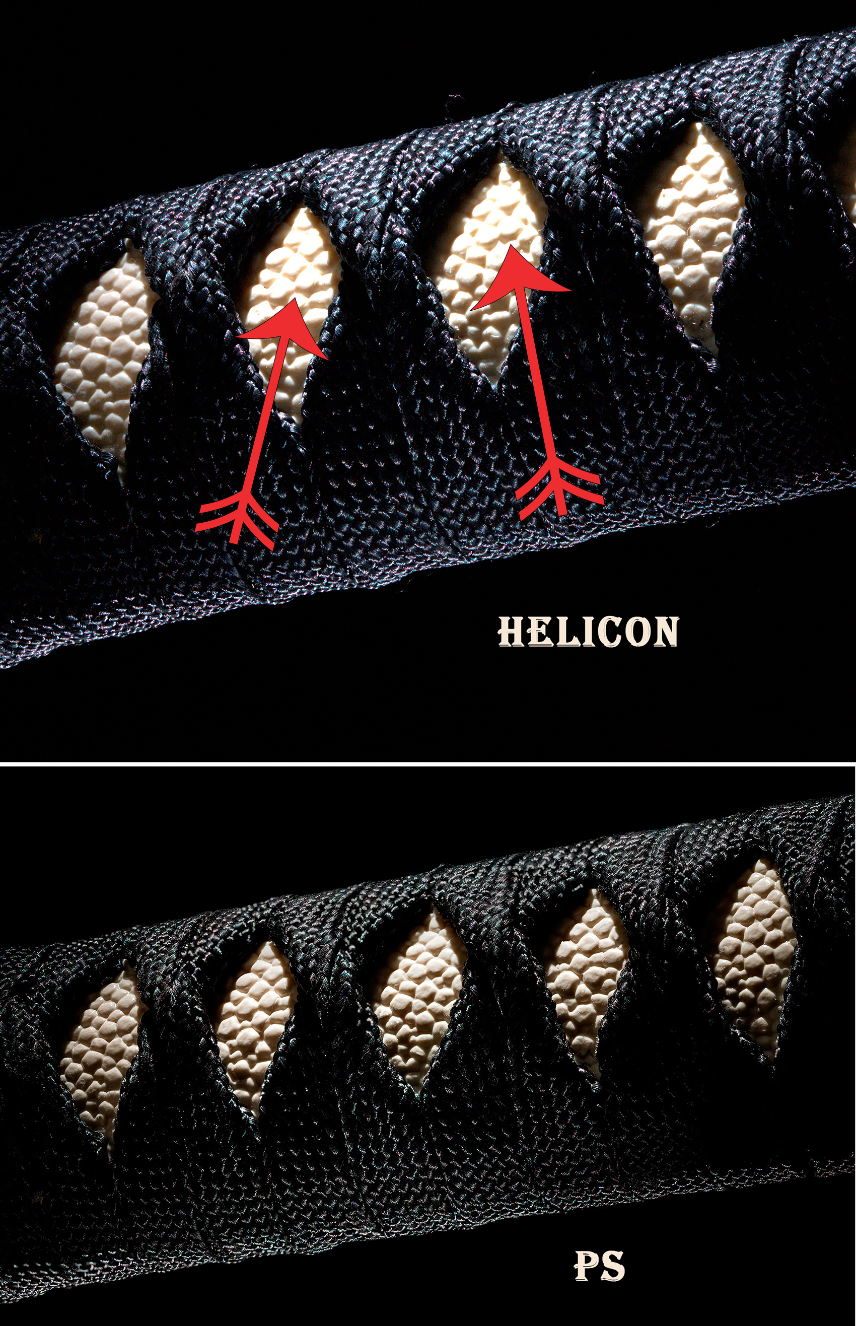

Can u please tell me why helicon blows out the highlight on the leather compared to photoshop? is there a tool in the software I need to adjust? It also telling me that highlights varies more then 19% yet light does not change. I,m assuming its a miscalculation or something, but look what it does to the highlight. Any thoughts please on how to fix this?

I suspect that depends on the RAW engine which you have chosen in RAW development settings in Helicon Focus (button under source image list). I would recommend to use RAW-in-DNG-out workflow to keep all the details (http://www.heliconsoft.com/raw-in-dng-out/)
