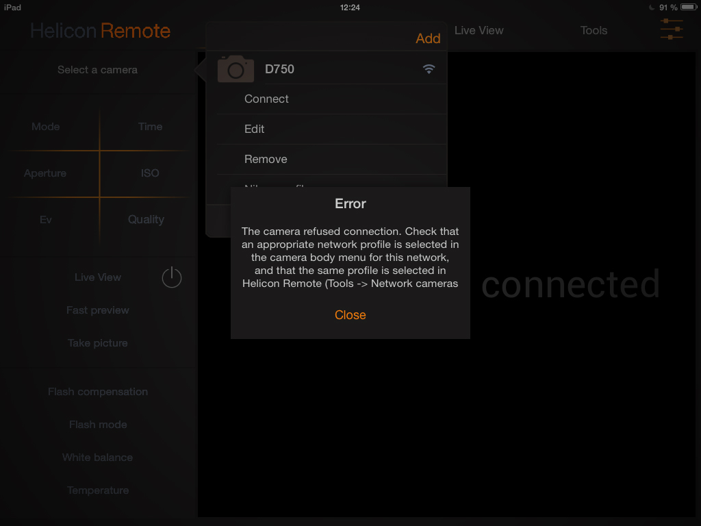

Ok, did that already yesterday:
1. Turned on D750 - Turn on WiFi - Reset Network Settings
2. Connect iPad to WU_xxxx Wifi - Checked IP address (192.168.1.2)
3. Turned on HR - waiting 2 min. no camera shown
4. Select camera -> nothing
5. Add camera:
- Name: D750
- Address: 192.168.1.2
- Type Nikon WT (tried Auto too, same result)
- Confirmed new camera with ADD
6. D750 shown in the Select Camera menu - select D750 - connect -> ERROR
2015-08-31 12.24.24.jpg (157.21 KiB) Viewed 8316 times
Posts: 3833
Re: Nikon Dxxx and iOS connection troubles
Make sure there's no other camera-related app running on your iPad. If there is none, and you're certain you have rest all the Wi-Fi settings in the camera body, then we don't have a solution for this issue.
