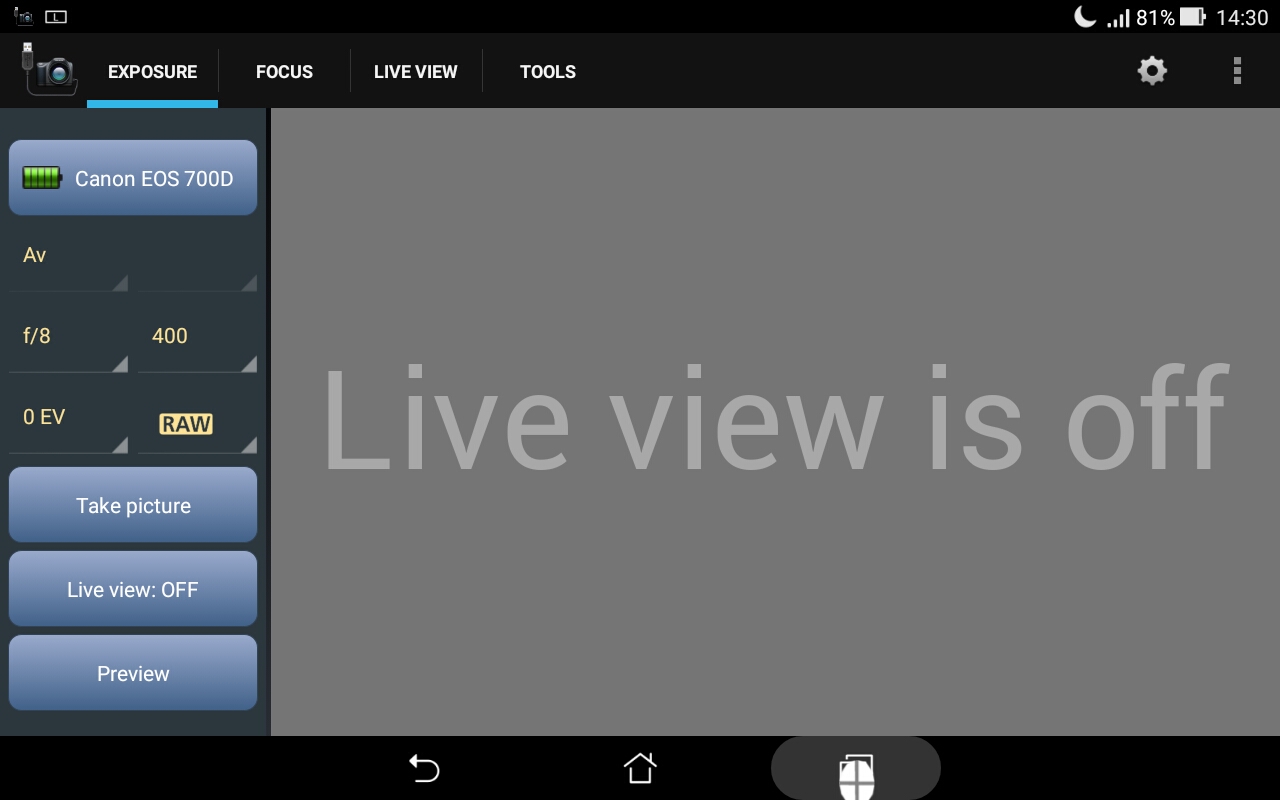

In Helicon remote it won't let me change camera models, between Av and manual for example, other software does let me do this but that means switching out of Helicon, loading the other app, changing the mode, then switching back to Helicon which isn't ideal and sometimes locks up the camera, is it possible for you to add this feature?

1. Try turning live view off, the exposure mode setting should unlock then.

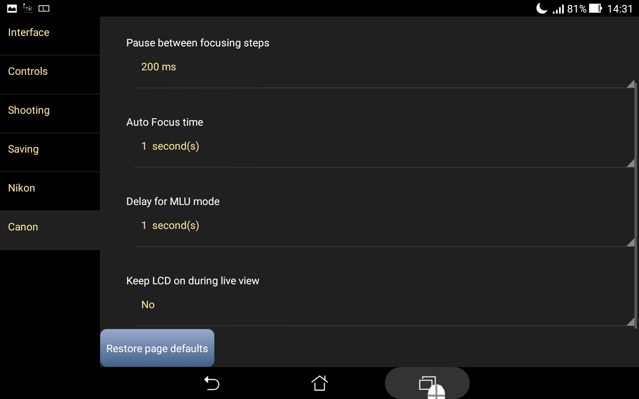

changing the camera mode still won't work with live view and simultaneous lcd live view off, looks like it's greyed out.
Any further way to debug? The tablet is rooted.
Long press for autofocus and tap for zoom works, for some reason long press for zoom doesn't, but as it's working the other way round I'm happy.
Posts: 3833
Re: A few questions/observations
Right, certainly looks grayed out, i. e. reported by the camera as read-only (not adjustable). Have you ever seen it not grayed out in Remote? Or have you seen this setting not available in that other app? I'm trying to figure out if the camera always erroneously reports it as read-only, or if there are other conditions that must be met for it to work.
