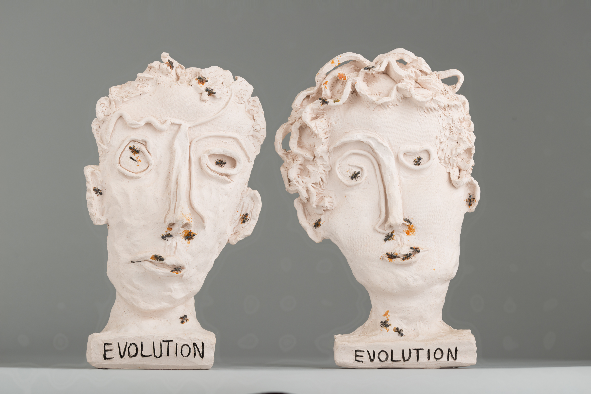

After stacking 14 images then using Helicon Rendering B factory settings the resulting image shows artifacts (light circles) in background and ghosting around objects like halos. Am using latest version of Helicon.

Re: Artifacts and ghosting
Usually this kind of artifacts appears when lightening of source layers is different and program is not able to fully compensate this because background and foreground are exposed non-uniformly. In your case it is better to disable this option (Preferences\Autoadjustment\Brightness). Or you can use retouching brush to copy background from any of the source images. With color tolerance of 30% the brush will affect only background.
We checked your stack again. It looks like these artifacts appear because of black area at the bottom of some images. This shadow is taken into account when the program calculates average image brightness. Because of this, layers are not properly adjusted and you see the halos in the resulting image. Workarounds: the image *0350000.nef differs the most. Exclude it from the stack and process it again. Another method: crop all images so that shadow at the bottom is not visible any more.
