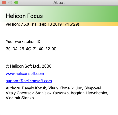

I uploaded a stack of 6 image files that are 16 bit tiffs shot on a Phase One IQ3.
The exported file is about 30% desaturated compared to the original file.
When first exporting the file into Helicon Focus it appears overly saturated, then exports under-saturated.
I see that other people have had the same problem.
I am running a trial version of Helicon Focus - downloaded today. Version 7.5.0
Image examples attached - the de-saturated one is the file saved out of Helicon Focus.

Re: Images De-Saturated when Saved
We fixed this problem. Please download and install the latest release of Helicon Focus:
https://www.heliconsoft.com/software-downloads/
