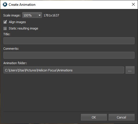

Hi, I just made my first stack from 13 semi-macro shots, handheld. Result is as good as I did hope. I even did some retouching (have the Pro version). To get to know the program I tried the different save options as well and liked the 3D output very much. But the animated stack didn't work out - seems like the images are not aligned at all. As stated, this was a handheld shot and pretty shakey. But in the composed stack, everything was aligned perfectly - why not in the animation?
Thanks,
Ralf
Re: Newbie question: Alignement in animation stack
Tick the checkbox "Align images"

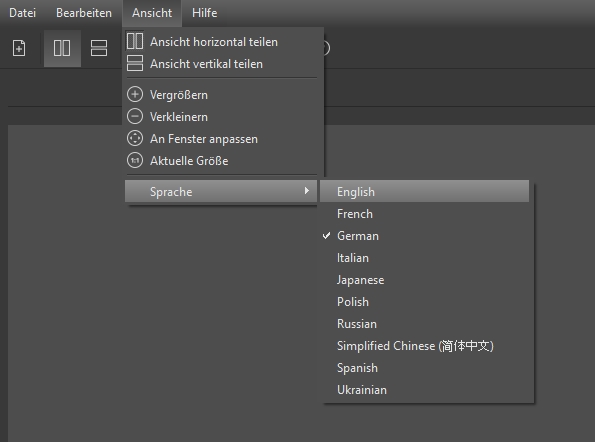

Ouch... I was already asking myself what the purpose of this checkbox might be because in the German translation the label didn't explain it as clear as in the English phrasing. And in the German help file that checkbox is not mentioned at all.
Probably I should switch to the English version! But how do I do this? I'm not aware that there was the choice of picking the GUI's language at installation or at the download.
Helicon Focus menu "View / Language"
