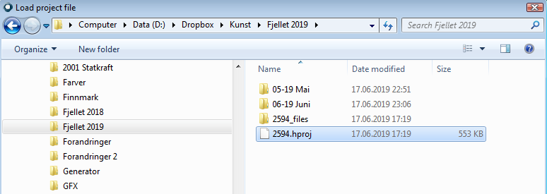

I have saved a project file, and when I try to open it, I get this message:
The project is saved on the D drive:

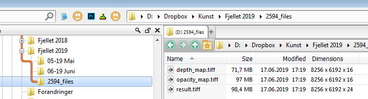

The project folder contains these files:

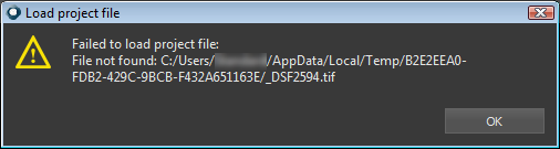

Failed to load project file
Re: Failed to load project file
The source file cannot be located because you opened it from a Temporary folder. If you were exporting from Lightroom - this is expected as Lightroom places exported files to a temporary location and then deletes them once the export process finalizes; you're not supposed to be saving projects out of Lightroom export for this reason. Instead, please load the source files directly to Helicon Focus.
