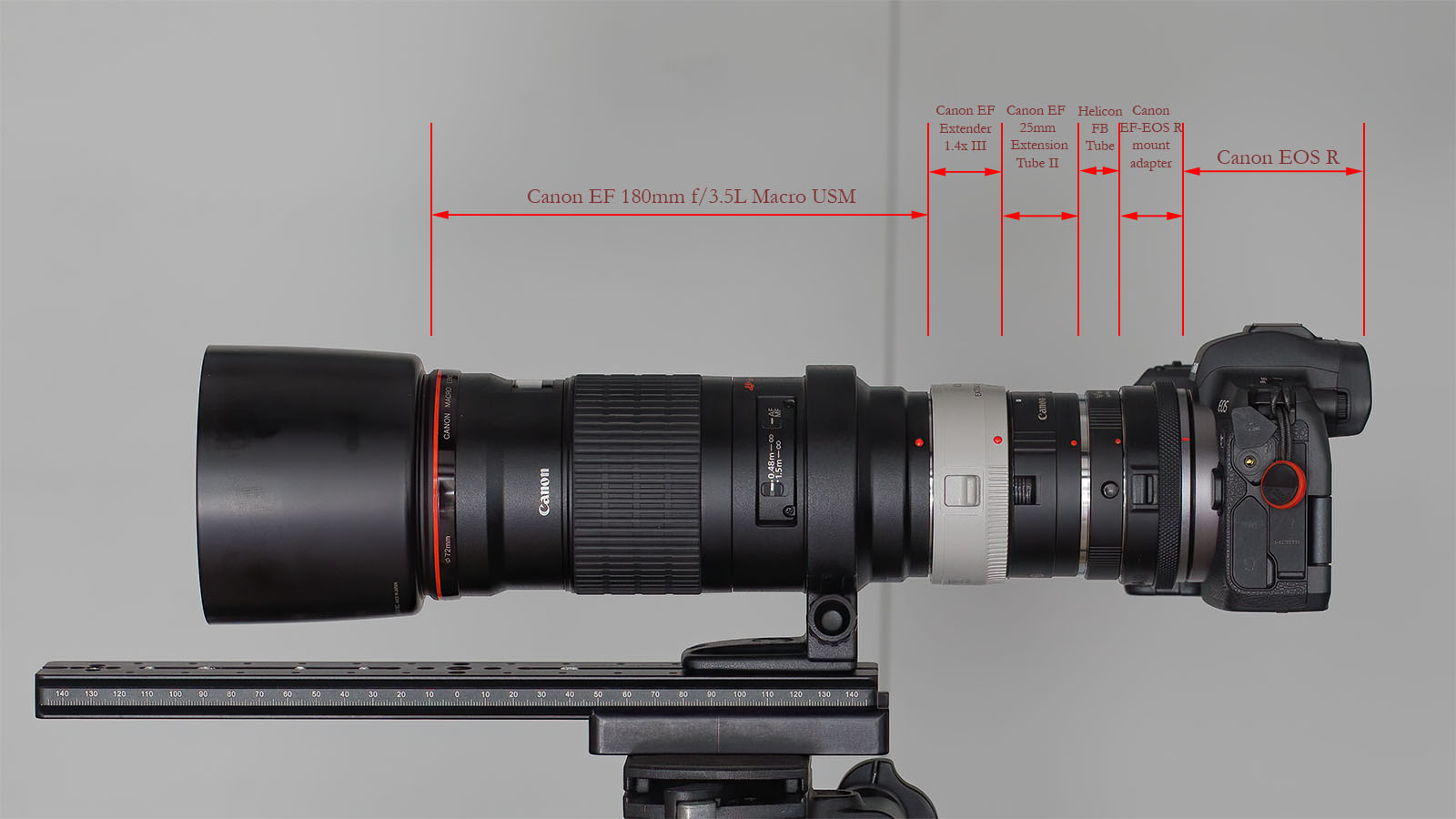

Here is a photo of my set up with the Canon EOS R and Helicon Focus Tube, plus a few extras in-between. :D
No issues at all taking stacks of 50 frames so far (that's when took my finger off the shutter release).
Cheers
Dennis
