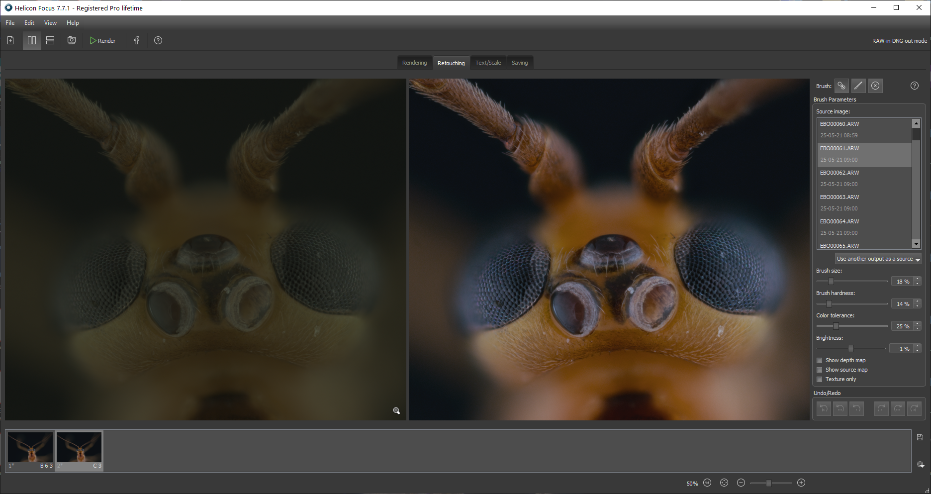

Good morning,
I've noticed that when I launch the retouching tool using the function "Use another output as a source", the image on the left is darker and pale compared to the image that I need to retouch in the right panel. The operation of pixel replacement works correctly, but the main problem occurs when we are in presence of darker images.
This problem was not present in the releases previous to the 7.7.0, but unfortunately is present in the 7.7.0 and this last one.
The issue is visible in the attached image.
Is it a bug or there are some (new) settings that must be modified?
The data stacked are native .ARW raw data format imported directly from a SONY A7R II camera.
Thank you very much for your support,
Enrico Bonino

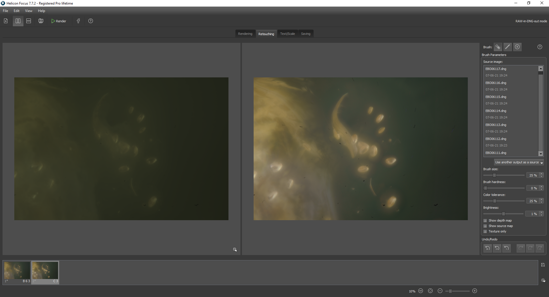

The problem arise also if I export from Camera RAW the source files (in ARW) to .DNG Format.
The image used as a reference (to copy from) is much darker and unusable.
Anyone has encountered the same problem?
