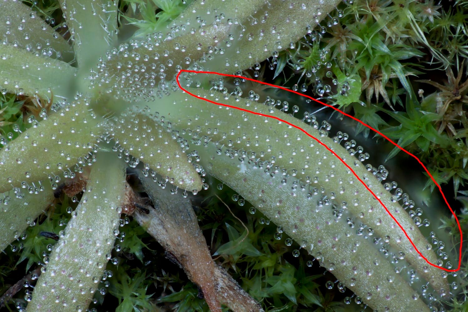

Blurring around complex shapes
Post by RemBrand »
Hi all! Recently started playing with macro a bit more using my old Canon 50D and a wemacro rail. One of my hobbies are carnivorous plants which is my current subject to take pics off at the moment. When taking stacks of sundew plants, you have the lovely dew drops. Around these complex shapes there's a blur most of the time which I can't seem to get rid of whatever setting I pick. Any suggestions?
Cheers,
Remco
  • 51 stack
  • Canon 50D
  • 100mm macro lens
  • f2.8 - 1/40s
  • WeMacro rail with 100um steps via Helicon Remote
  • led lights
(301.06 KiB) Not downloaded yet

Hi Remcon,
I've spent a lot of time on this issue. But even so, I welcome others who are more knowledgeable about optics to correct or improve my answer.
The normal set up of a camera has the sensor fixed in place, and the lens moves when you refocus.
Distance to the image (Di) divided by distance to the object (Do) = Magnification
When you move the lens closer to the sensor to focus on the the farther object, Di decreases and Do increases. The magnification gets smaller.Apparently, HeliconFocus deals with this by changing images sizes to match the magnification. That's good, but it leaves a big out of focus foreground object next to the in-focus background in the faraway images. You end up with halos around near objects since you your faraway images have a big "shadow" of the nearby object blocking the in-focus far away object, and the nearby images have no in-focus pixels of the faraway objects.
I spend a lot of time and cloning background data onto the halos if they are annoying. I use some combination of the stamping tool and the spot healing tools in Photoshop.
See the images I am posting later today of the orchids for an example. Look at high contrast original and final, and compare the halos around the nearby leaves. It's not perfect, but it's a useful improvement.
Phil

I know this is a year old thread but still:
If you have a lot of complex structures in the foreground and background you may want to use Method C (pyramid) instead of Method A or B.
Method A and B are great for flat surfaces without too many changes in dimensionality or rather geometrical figures. With complex overlapping, dimensional stuff Method C often gets better results, though the contrast sometimes suffers.
Personally I would suggest combining methods for the cleanest results and/or render the foreground and background objects separately and then combine them.You could even combine these rendered images again in Helicon Focus without resorting to Photoshop.
EDIT: as for the original image I would probably change your shooting parameters as well.
With a 100mm macro lens f 2.8 at 100um steps isn't quite necessary or beneficial unless you're shooting at 3x or 4x magnification and you're diffraction limited. At f2.8 you will have a very shallow DOF and that will cause a very sharp separation of foreground/background elements - which will make if more difficult to then stack them properly.
Instead you might want to try f4.0 or maybe even f5.6 - as a benefit you will need fewer images and your step size doesn't have to be quite as small.

Hello Gregory and shutterbug,
Continuing this antique thread. Sorry for not getting back to you soon.
I'll try method C, but I predict it won't help much because of the magnification issues I posted earlier.
Paraphrasing what I wrote in 2022:
As you move the lens closer to the object -- as when you focus on a near point -- the magnification increases. As you move the lens away from the object towards the sensor -- as when you focus on a far point -- the magnification decreases.
Consequence: Halos happen around nearby objects because the far-away in-focus pixels near the edge of the nearby objects are blocked by the in-focus nearby and larger objects.
The good news is I've found a new way to fix a lot of halos. With the combination of careful use of the lasso tool and "Content-Aware Fill", you can fake a lot of the halo into looking like the background.
Phil

Method B, as I posted earlier today
/https://www.dropbox.com/s/wxuy73g1igs4p ... y.jpg?dl=0
Method C, as suggested by shutterbug
https://www.dropbox.com/s/c7gbdiiw1u42k ... y.jpg?dl=0
I was wrong. Method C is definitely better. Look at the left edge. And more interesting -- look at the horizontal curved line at the bottom of the top center large area. C made both of these better. Not perfect, but better in both cases.
I was wrong. shutterbug was right. C works better at decreasing halos! Thank you, shutterbug. I am switching to C for images like these!
Phil

I've got a new analysis/understanding.
I did the math about the magnification change, checked it at least three times, and had another mathematician check my work. If anyone is interested, I'll post the equations. They require no more than high school geometry and algebra.
Conclusion 1.
The nearer the focus, the greater the magnification. Therefore, if you have a tight composition, compose it while focused on the nearest object. Otherwise you will lose parts of the image around the edges.
Conclusion 2. The near object shrinks more than the far object when you focus on the far object. This is the opposite of what I thought was happening. Therefore, the blurring is due to the out-of-focus spreading of the near object when we're focused on the far object.
I shoot my focus stacking images at f8. My next experiment will be to do a second set of focus-stacked images at f32 or something like that to see if I can use a closer-focused image of the far object with a less-blurry near object image. I'll give up the lack of diffraction at f8 if I can get a more focused image where the halo usually resides.
If anyone has other ideas or tries this, please post your ideas and results.

Hello Phil,
I might miss a a point but I think this is a wrong assumption:
"Paraphrasing what I wrote in 2022:
As you move the lens closer to the object -- as when you focus on a near point -- the magnification increases. As you move the lens away from the object towards the sensor -- as when you focus on a far point -- the magnification decreases."
Why could this be wrong? When we do focus stacking, indeed we are moving the object towards the lens (or vice versa).
However -we do this to change the focus on the next area of sharpness! That means the distance between the lens and the sharp area does NOT change.
As an example: I use a 10x lens, the lens has around 7micrometer depth-of_view (DOV). While stacking I move the lens lets say 3-5micrometer towards the object. This results in the same distance between lens and sharp areas for each single image of a stack.
To my understanding Helicon does not scale the images during the stacking process, it can compensate small amounts of vibrations or rotations by scaling the images, but this is an "add-on" and not directly related to the stacking process itself.
"Consequence: Halos happen around nearby objects because the far-away in-focus pixels near the edge of the nearby objects are blocked by the in-focus nearby and larger objects."
Here I fully agree - because the blurry parts are the part of the image that moves towards the lens and hence they change their size because of a change in magnification.
as said - I might miss a big point here and I am happy if you proof me wrong ...
best regards
Marc

Hello Marc,
Helicon Focus does scale images during alignment, if it didn't - it wouldn't have been able to produce acceptable output, as the magnification of the subject changes as you shoot at different focal planes. Like you said, the distance between the lens and the area of sharpness is constant (unless you change any optical parameters of your setup), but the area of sharpness moves along the subject, which means that the subject moves relative to the camera. And closer objects take a larger area on the camera's sensor, i. e. they are magnified (effectively). It's an inherent phenomenon of focus stacking.
