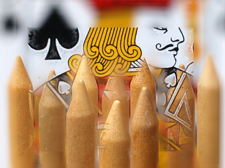

I have a sample image to illustrate this. See below. (Dan, I'm happy to upload the stack.) The scene is ten golf tees in a bowling pin pattern with a playing card 35mm behind. The depth of the scene is 75mm from the closest golf tee to the playing card. The lens-subject distance is about 150mm.
More: Changing the focus shifts the lens forward and back, changing the perspective. Not as much as moving the camera, but some. In my test scene, I get artifacts changing the focus. It seems to me that to keep the same perspective, you want to avoid moving the lens. You can get different focal planes by using a bellows and moving only the rear standard (the "film") and not the front standard (the lens). It seems to me that this should come closest to maintaining the perspective in the scene.

- Moving the camera. Scene depth is 75mm. Lens-Subject distance about 150mm.
- MoveCamera.jpg (131.66 KiB) Viewed 27750 times

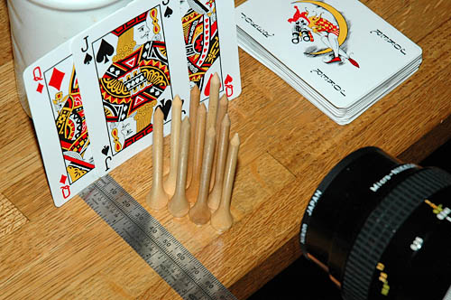

Here is a photo of the setup that produced the image above.
- Setup for the perspective test scene (previous post).
- PerspectiveSetup-3390sm.jpg (102.45 KiB) Viewed 27749 times
Rick,
Thanks for the samples.
You can create web animation from Helicon Focus (win version) and upload it to our ftp server (ftp://upload:[email protected]/httpdocs/) and then post the link to this forum.
Looks like this is difficult case as even changing the focus moves the lens and changes perspective.
Ok, one more crazy idea: set the camera on the small table, then change the focus so that the lens does not move (camera moves backwards). Maybe backward movement will compensate perspective change.
And one more major problem: When placing the lens so close to the object, you can actually see details _behind_ the object. I think that making smaller aperture should minimize this effect.

I uploaded the stack to the ftp server in a subdirectory JackOfSpades -- I'm on Mac so can't make the flip-movie.
Thinking more about this test image... I think the problem is that the camera movement changes the perspective BETWEEN ADJACENT SLICES, in this case, the last golf tees and the background card. That creates the ghosting and details breaking through the foreground objects. This test image is VERY difficult to composite.
It's a tough problem. Even if there is NO change in perspective, the camera can see around the foreground objects and the same pixels will be sharp in both the foreground and background slices. Only manual masking will get the right pixels into the final image.
Dan, your idea of holding the lens steady and letting the camera move is exactly what I had in mind... It's the same as focusing with the rear standard on a bellows, leaving the lens-subject distance unchanged. I think this will produce a better result.
Back to the practical... I set up the Jack of Spades test because I was worried about shooting a bouquet of flowers. I was worried the perspective shift would mess up the bouquet image. In practice, it's probably not a problem. I did another test showing that as long as the objects are distributed throughout the scene depth, it's not a problem, even when I make slices by shifting the camera.
The perspective shift problem does arise if I try to do the whole bouquet and THEN add another slice for the background. My conclusion: If the perspective changes from one slice to the next, then you'll get artifacts. If there's a big focus change between any two slices, it's very tricky.

Yep, I've played with the stack a bit. It cannot be make perfect even with manual retouching. Some information is simply missing.
Here is web animation:
http://upload.helicon.com.ua/JackOfSpad ... mation.htm

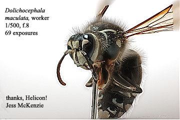

Here (attached) is the result of 69 exposures of a hornet (killed by freezing). There were plenty of opportunities for "bowling pins," but none presented themselves. to my surprise. Thanks to Manfrotto and to Helicon.
Questions?
~jess
PS: Note the peculiar "halo" effect at wingtips. A mystery to me.
PPS: The genus is Dolichovespula, of course; not Dolichocephala. My apologies.
Questions?
~jess
- For_Helicon_hornet.jpg (57.03 KiB) Viewed 26645 times
