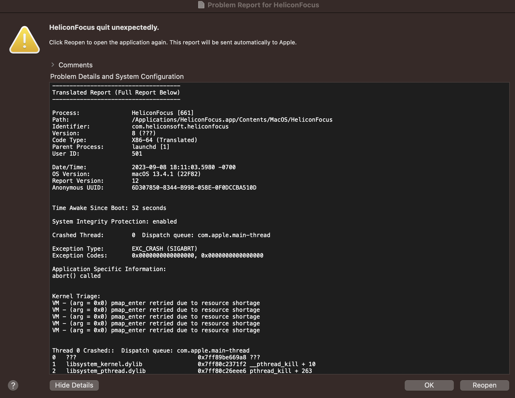

- (644.63 KiB) Not downloaded yet

On the screenshot I see that Helicon Focus crashed, but the important part of the error report is not visible. Please select and copy all the text from the "problem details" section (Cmd + A, Cmd + C) and send it in an e-mail to [email protected]
