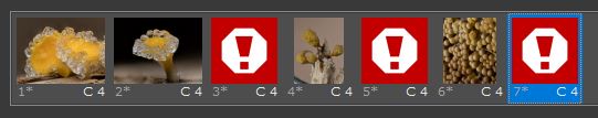

I am using Helicon Focus since quite some time now and never had issues with it, until I reinstalled Windows 11 some days ago.
I switched my Boot drive to a new PCIe4.0 nvme M.2 SSD with 1TB and 7400r/6600w.
I have installed Windows 11 completely from scratch with a bootable USB and installed all drivers, Helicon 8.2.2.0, latest Adobe DNG Converter and also the latest Adobe Camera Raw.
Since then I get an error message when I try to stack the .ORF files from my OM-1. This was working perfectly fine before the reinstallation.
It is not happening to each stack but for sure every second one, independent of the number of shots I select, it sometimes happens at the first image or sometimes at the 50th.

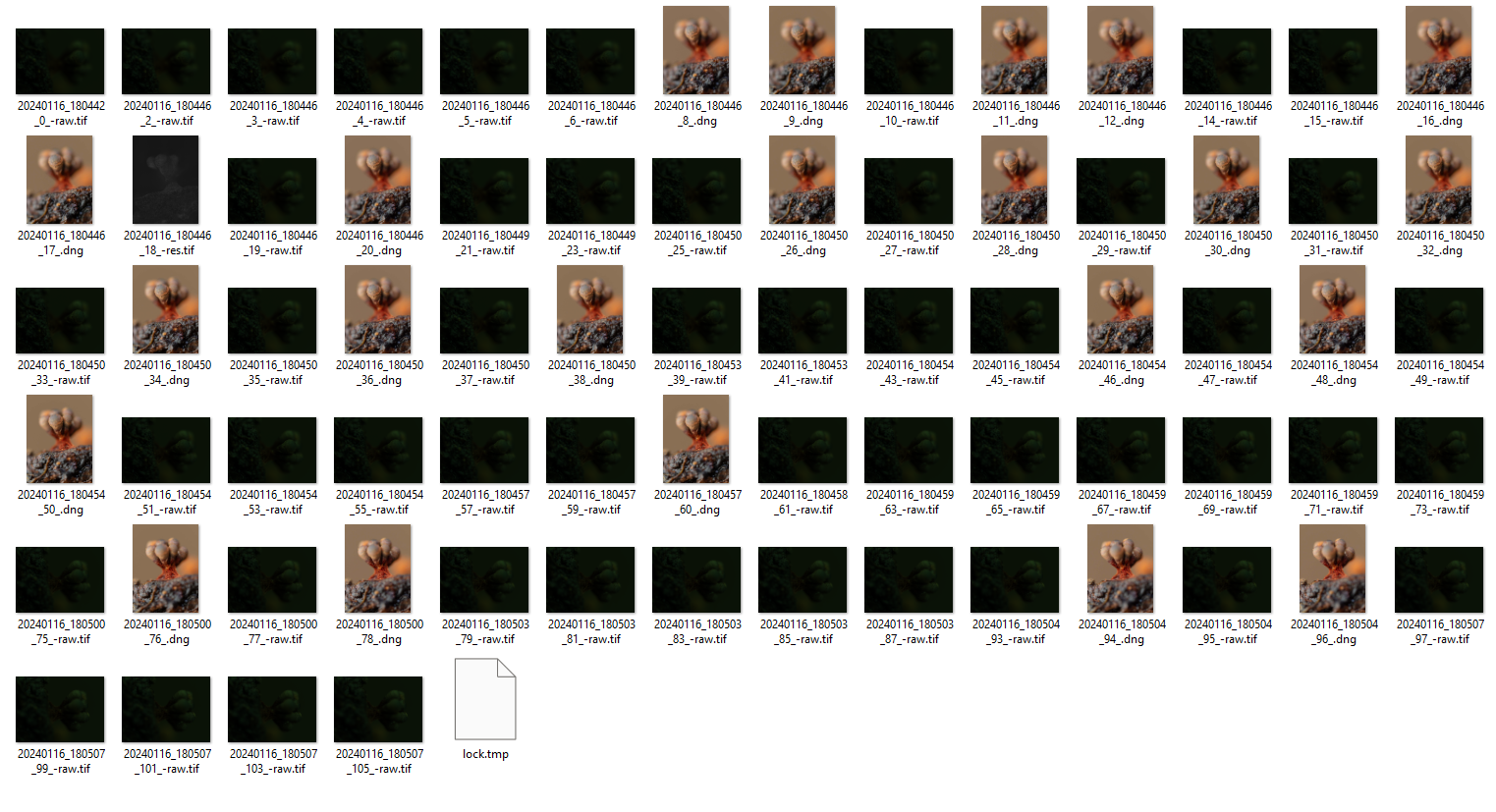

Now I also found out that the files in the cache folder are sometimes .tif and some are .dng > see screenshot.

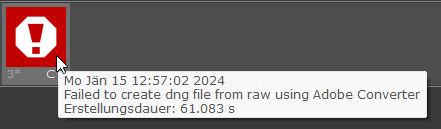

Error message: Failed to create dng file from raw using Adobe Converter
