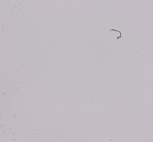

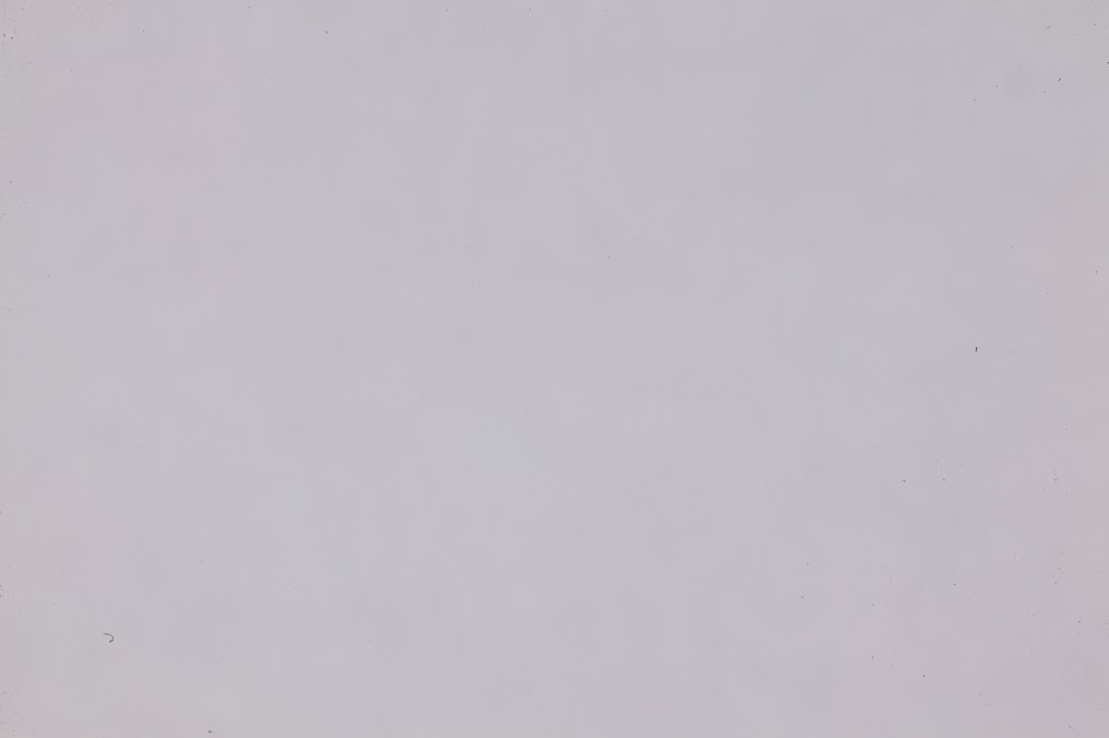

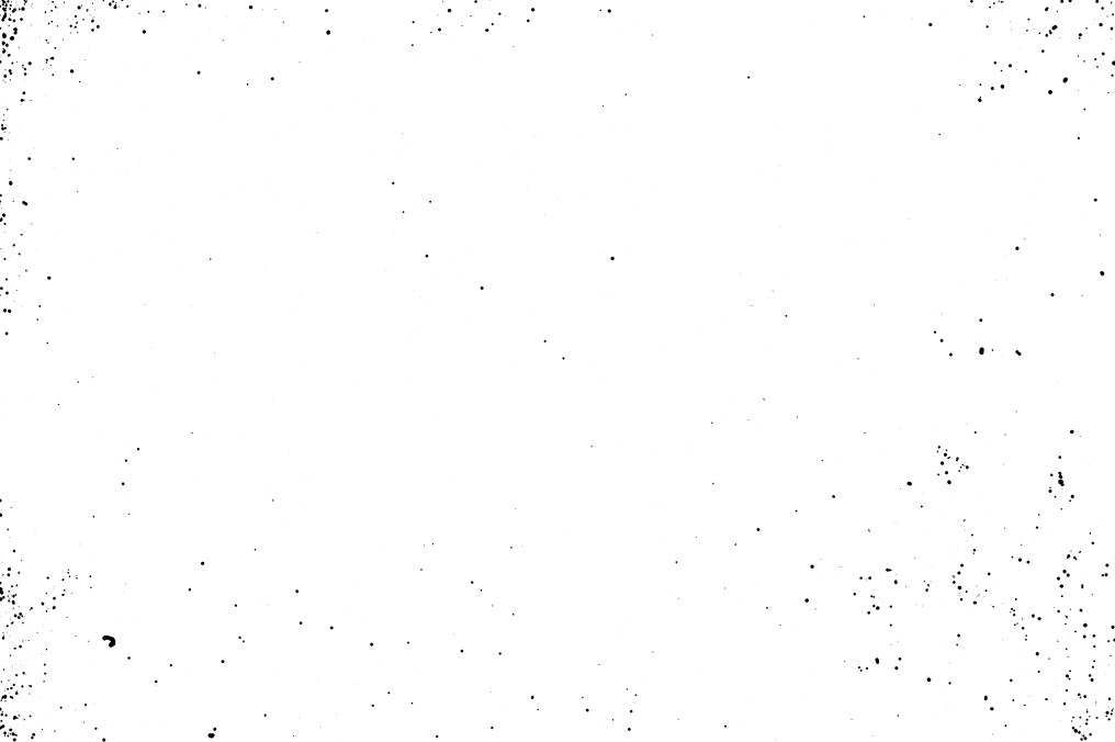

No matter how carefully you clean your lenses and chip there will be residual dust left, plus the drying rings from the cleaning fluid (I use Eclipse from Photo Solutions).
When you use a macro lens with 1:5 magnification and view the image on a 21" monitor (320 mm high), you have a viewing magnification of 5x320/24 = 66x. At this magnification a speck of dust in diameter of a human hair will be about 3 mm.
If you shoot a series of pictures (e.g. 10) and adjust the focal point each time to focus on another depth of the subject, the picture size changes, but the dust remains in the same position. The result is a string of 10 dust "beads" and if you have dozens of dust spots (that's a clean lens!) the picture looks awful.
Fortunately Helicon Focus has a dust map function which cleans up this problem. I use it with great success. Keeps me from having to clean the lens more often than desirable as this is a very delicate task.

Here is what Helicon Focus Help says about it:
To use this function follow these steps:
1.Prepare "white frame". After (or before) you shot all other images, make unfocused (!) shot of the white surface, so that dust on the sensor can be easily identified.
2.Start Helicon Focus, add stack of images.
3.Add dust map using "File->Add dust map" menu command.
4. Run combining process.
Please note, that dust map should have the same dimensions as all the other images in the stack."
Is this clear enough or should I describe the process in more details?
