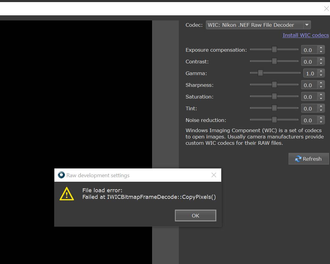

And I also ask you to comment on the error in the screenshot.
Error for 3-rd conversion method
Ошибка при использовании кодеков Nikon 3.jpg (48 KiB) Viewed 11683 times
DCdraw converter.
(263.72 KiB) Not downloaded yet
Posts: 1857
Re: Soft output compared to Photoshop
The error most likely means that the installed Nikon codec doesn't support the camera that the image was shot with. Either way this is an error returned by the codec itself and there's nothing we can do about it.
I think comparing to focus stacking with Photoshop or other software is not the right way because there are two variables (raw conversion and the focus stacking itself). It would be better to compare raw conversion separately.
