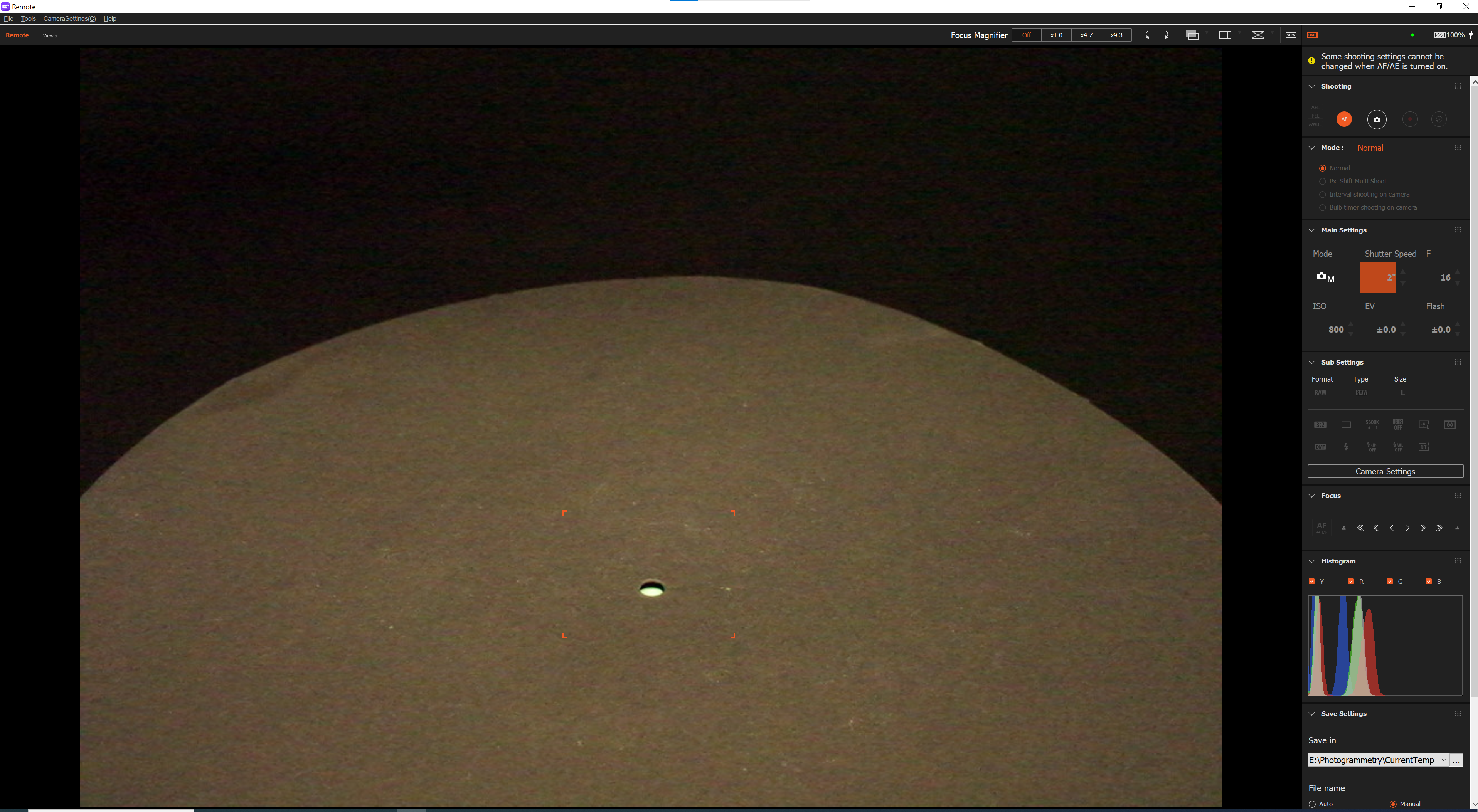

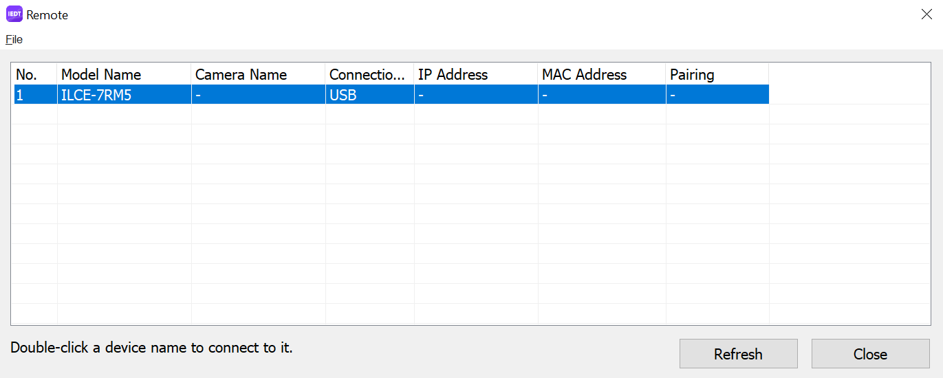

i tried to install the version you linked me, but it doesn't detect the camera (although it is correctly detected by sony's imaging edge software).
I am attaching screenshots and the 2 logs:

Re: A7rV Support
The Sony software replaces the standard camera driver, so neither Windows itself nor Helicon Remote can detect it. One solution is to use Device Manager, find the USB device corresponding to the camera, and delete it (and check the checkbox to also remove the driver files). Then reconnect the camera and let Windows install the default driver.

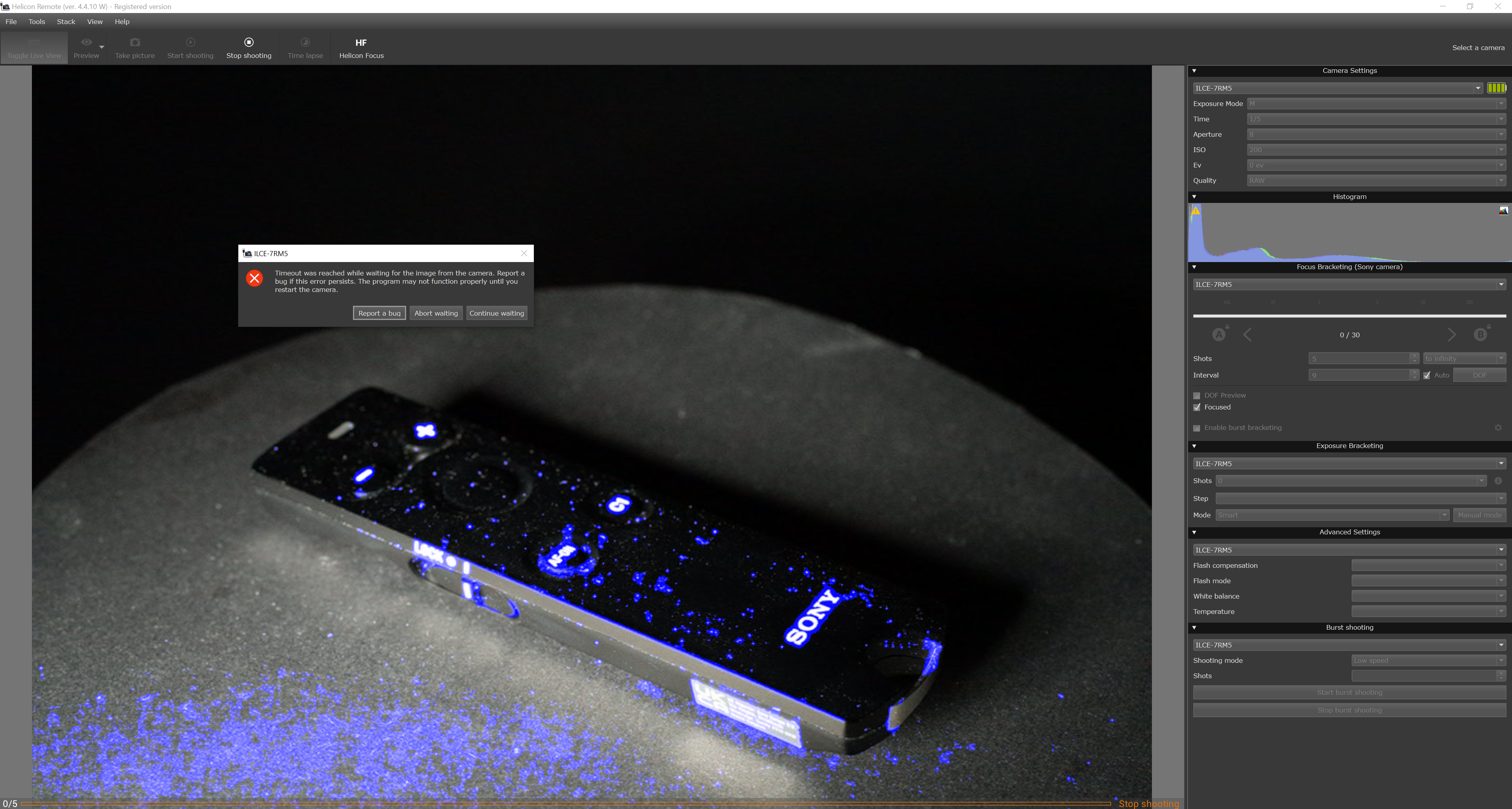

Post by christianronchi »
I managed to connect the camera by following the instructions you gave me.
There are a few things that don't seem to go right:
1.)once I set the minimum and maximum focus points, the number of shots, and start the shooting session, it only takes the first shot and then waits without doing anything
2.)it is not possible to cancel the shooting session, the software goes into timeout whether you press stop shooting, or continue.

Re: A7rV Support
Thanks for trying that. Please update the camera firmware: https://www.sony.com/electronics/suppor ... e/00292267
Then try again, and send a bug report if something still doesn't work: menu - Help - Report a bug (don't attach the logs manually unless the reporting tool doesn't work, which should pretty much never happen).
