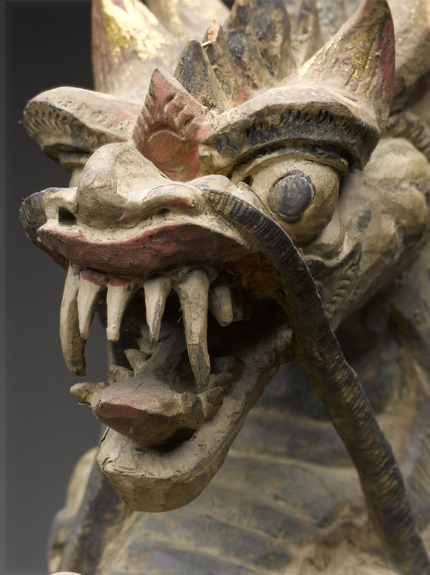

I did a quick and not too rigorous test of moving the rail vs moving only the back and keeping the lens in the same spot.
I shoot commercially with a medium format back mostly on a large format type camera, that is a non focusing lens with bellows and front and rear standards.
So for the first I focused the camera and moved the entire set up forward via the rail for each slice, for the second I kept the lens where it was and moved the rear standard forward for each slice.
Very similar results for both from an overall performance standpoint, there isn't any difference in overall sharpness.
Halos appeared in the same spots on both although the fixed lens series might be a teensy bit better.
It appears you need fewer slices with the fixed lens series and the focus shifts back through the scene quicker as well. It also appears you can do a deeper depth of focus with this method as the scene itself doesn't get bigger and thus go out of frame as it does when you do the advance the rail type setup. This can seen readily in the BackMove jpg.
There hasn't been any sharpening applied except for a small amount in Iridient Raw Developer.
