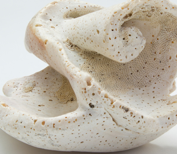

Post by peteschick »
Can you tell me why the center area is blurry? I'm using about 25 photos shot at f11, method B, radius 16, smoothing 8.
I would recommend you to use smaller radius to make the blurrness around nearest edge thiner. An you may try to use F16 or higher. Look at your image of the farthest part of the object. You'll see that the nearest part become unfocused and covers part focused areas.
