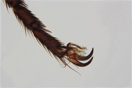

I have had a bit of success, I have just taken a sequence of images to produce the image of the leg and hooks of a Housefly. The marks on the hooks are under the cover slide and were there when I was supplied with the slide, so not guilty on that one
This is my first posted image so I would be grateful for any constructive criticism.... Many thanks
