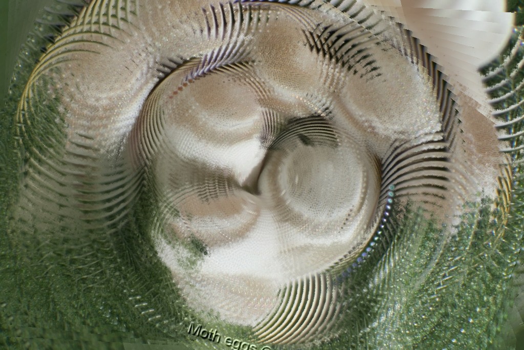

after I've done two stack images with helicon focus with excellent final images I get a problem with new ones. I load a new gorup of images and when I process them the first image load right, but the second rotates 3-5 degres clockwise, and so on. The final image is a skewed image of all of the images of the stack.
How could I fix this bug?
Please install the latest version. This should fix the problem.

Maybe, maybe not, but this looks like what I got when I had accidentally unchecked the box in preferences, adjustments, horizontal.

Have tried your suggestion but not working.
This is definitely not the latest version. I would suggest to upgrade to 4.77 version.
