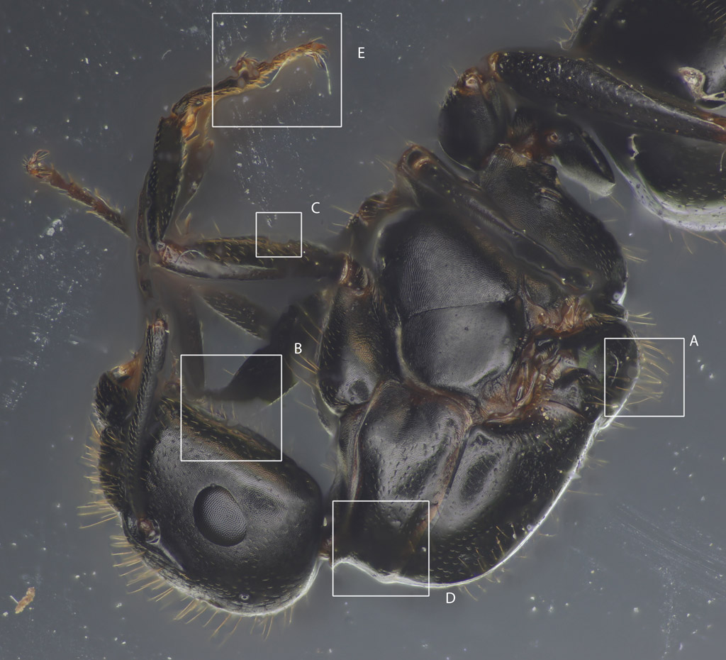

After many tries with stacking methods and parameters, this is the best I can get (from around 200 images). Has anybody ever experienced these artifacts (too many to get rid of with the retouching tools), and found a way to remove them ? :
A : Hairs are only partially visible and smeared. This occurs on vertical sections (on less steep ones, it's ok)
B : On place with overlapping features, the background is sometimes removed.
C : Hole on the edge of the arm (whereas there is no such artifact on any of the pictures of the stack)
D : There is a zone with no details at all, whereas it's not the case on the pictures on the stack
E : Colored halo (kind of blooming around small features of the image)

I would suggest you to set Depth map smoothing on the Preferences/Autoadjustmento to 0. And I think the overlapping can be too big, I would use every second or every third image to see how it would change the result. You can also set interpolation to bilinear to speed up the processing.

I've tried to lower depth map smoothing and to take one picture out of 3. But it didn't change much the result unfortunatly.

I've played with your stack yesterday. I am amazed that even 200 images with F8 do not have excessive overlapping! A remarkable stack that produces very smooth 3D model too. I found that method A, Radius 16-24 and Smoothing 1 give the best result to my taste. It is not perfect but smooth,natural looking and preserving fine details in difficult places.

I realized that I tried a range of parameters far too small. I thought radius and smoothing should be kept low, and you're right, with a larger radius, it gives nicer results. Manual retouching is now more bearable.
Knowing the internals of the algorithms, do you think problem with fine details on the edge (the hairs) and at intersection of objects focused at different planes could be solved in an upcoming version ? Or maybe a combination of two rendering with different parameters could be the solution ?

There is an optical problem. Each hair when unfocused hides the background behind it. So I would suggest you to set lower aperture (F11-F16) and see if this would help. I've tried to change some internal parameters of the algorithm but the result is not better. So far we have no ideas how to get better results from this stack, sorry.

I'm not sure a smaller aperture would help considering the very tiny depth of field, and my optical assembly (the real aperture is not what is written in the EXIF) but i'll try that.
I don't see how I could optically avoid out of focus overlapping parts to mask in focus ones...
