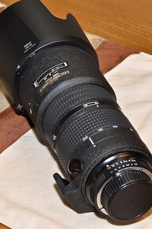

My first try went quite well. Thank you!
D90/TamronSP 60mm Macro at F/4.0
