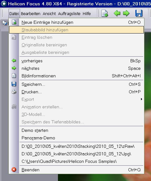

No, I can´t... :-) My version is in German, attached you can see a printscreen from my - filemenu.

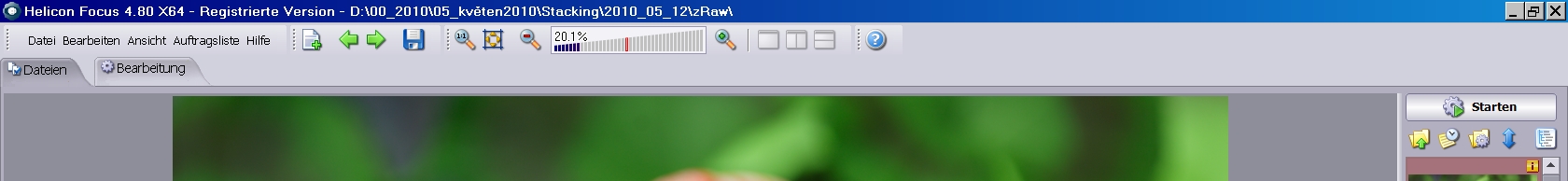

And here my toolbar...
(147.12 KiB) Not downloaded yet
Re: Helicon Focus and Remote Stacking
Please download and install the latest release of Helicon Focus:
http://www.heliconsoft.com/focus_downloads.html
marky558
Posts: 8
Joined: 10.05.2010 22:57
Post by marky558 »
Thank you very much Stas! SW downloaded, installed and all seems to be o.k. Where was the problem??
You had an old version of Helicon Focus (4.80) which did not include Helicon Remote.
