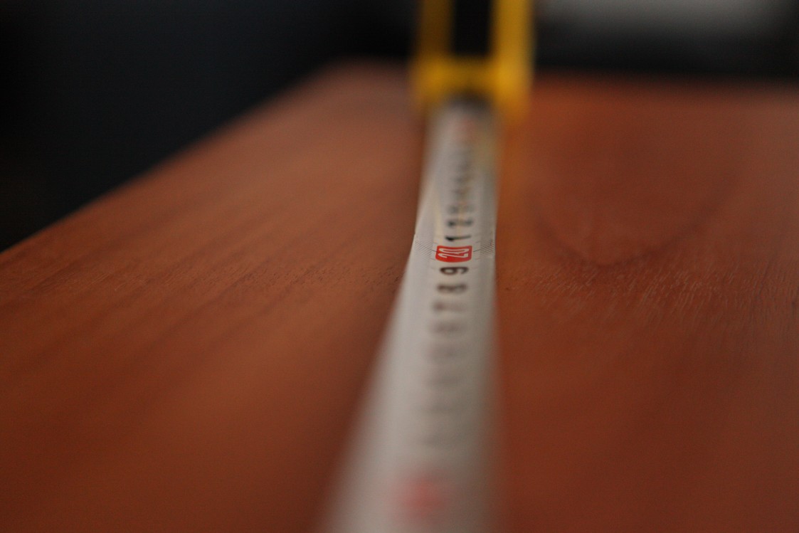

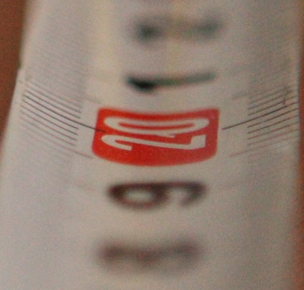

Please see below the setup we use to test focusing steps. The second image is 100% crop. With such setup it easy to follow how the focusing plane is moving. If the focusing step is ignored, you will see this at once.
- Full image, resized
- 456_000_1.jpg (80.91 KiB) Viewed 15632 times
- 100% crop
- 456_000_2.jpg (60.27 KiB) Viewed 15632 times

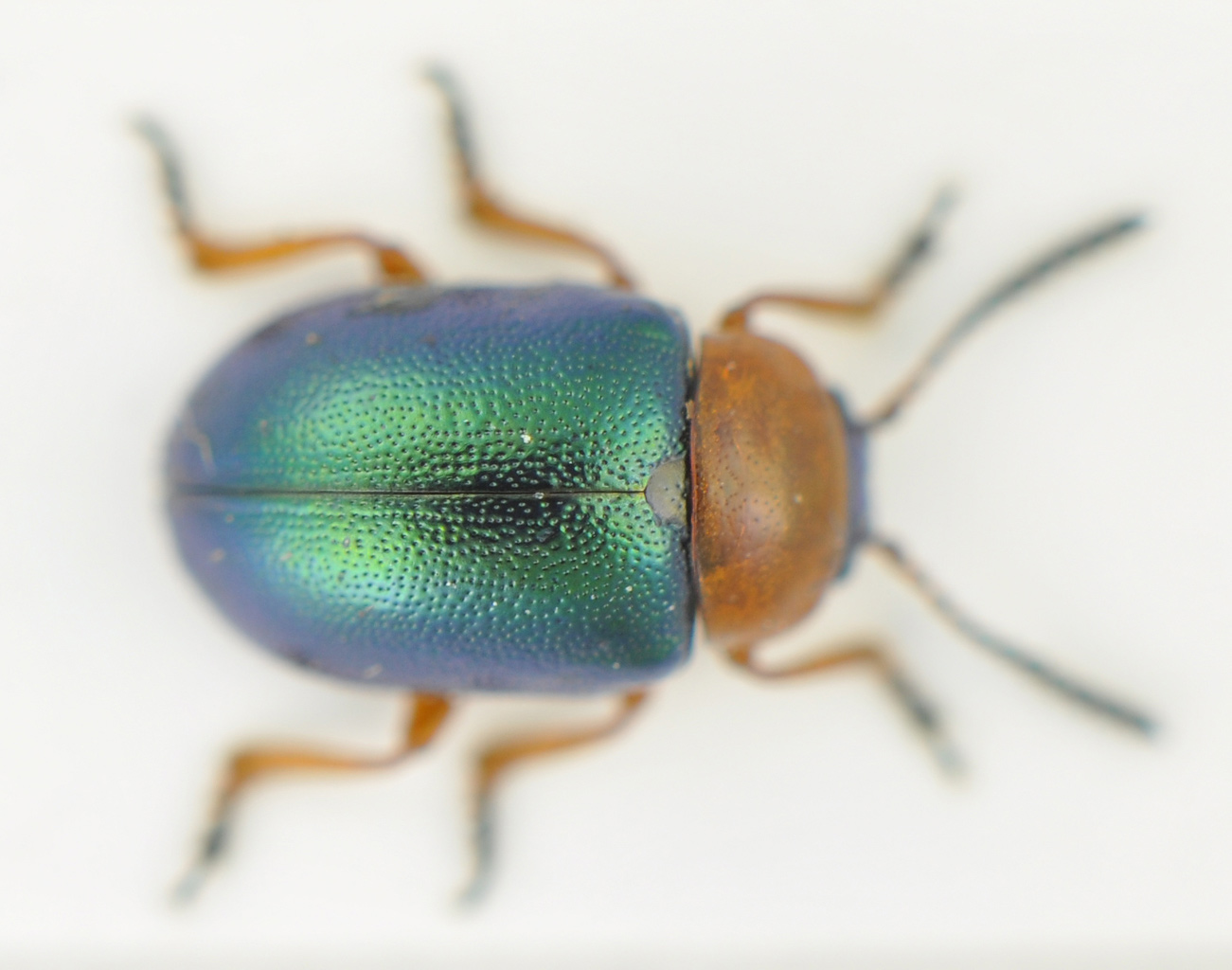

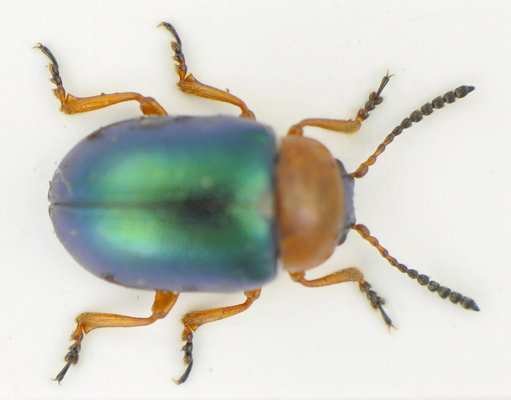

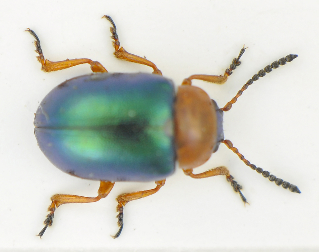

I'm from Italy. First of all, please excuse my poor English.
I'm just starting trying Helicon Remote trial version. I use Nikon D90 with AF-S DX Micro Nikkor 85mm F3.5G VR and Kenko Auto Extension Tube Set DG.
I followed your instructions to set the nearest and farthest points, distance between shots 2, and started from farthest point (direction towards camera) but.....
here I am attaching first and last image of a series of 19 both corresponding to the farthest point while this is the image taken at nearest point So, to obtain a series of shots to stack with Helicon Focus, I had to take single pictures at different DOP, that is quite time consuming. How could I solve the problem?
Thanks in advance for any suggestion and help
- Posts: 3833
Re: focusing
Yes, it is evident the focus plane had not moved. As I understand, you are able to move focus from the interface with ">" and "<" buttons, but it does not work when you start shooting. Please send us log file after such a shooting which you will find in Preferences\Tools. Please also contact us at [email protected] and we will send you a newer beta version for tests.
